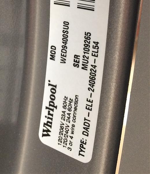

You are really helpful. Thanks for your guidance, I am having an F25 error code as well with the heater not heating. I believe that I need to also get the “hi-limit thermostat kit”. My issue is my model number is wed9200suo and NOT wed9200sqo
Is teh part the same? Anybody?
The model number you posted (WED9200SU0) does not come up. Please verify the model number and repost it. Thank you.
Model number is: Wed9400suo or am I missing something?

[quote=travishenry;902538]Gene,
Is teh part the same? Anybody?[/quote]
Yeah, you’re missing the “4”.
You typed WED9200SU0
Your pic shows WED9400SU0
