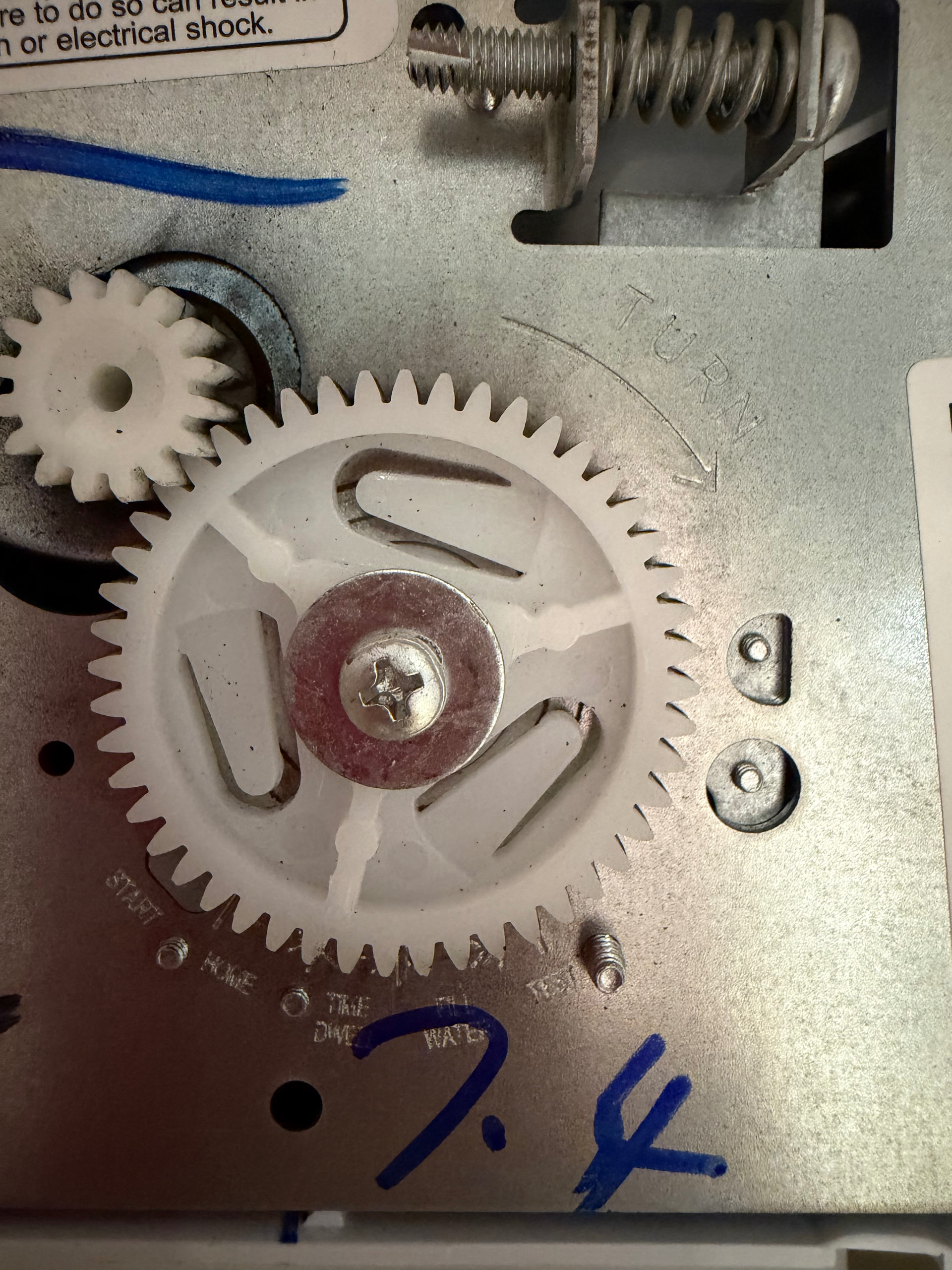

What happens & when: ice maker stopped making ice . Had a repairman come out and diagnose it. He said it was the auger motor . While replacing that I noticed there was still ice in the tray . Put everything back together and crossed my fingers. Now I’m not getting water to the Tray , but the auger motor is working . I do not have any ice build up anywhere . I’m thinking it may be the freezer water fill tube but Not sure . I didn’t see any cracks or anything on it when I check it . Also the water in the door is still currently working . Please help

My freezer does have a T or H port but it does have a start and a test spot . Am I supposed to bridge those two ports ? I want to make sure before I try it .
With this ice maker not having the T and H ports to bypass the thermostat, voltage to the ice maker would need to be verified before proceeding to activating a harvest mode. At the wire harness connection, a meter can be used to test from the violet wire to the white wire. There should be 120 Volts AC. If voltage is present, carefully rotate the center wheel clockwise until it starts to rotate on its own. This should get the ice maker to go into a harvest cycle if it is receiving 120 Volts AC from the main control. Here is an image showing how the ice maker circuit should work. The gray lines are the white neutral wires while the other colors are what colored wires would be found at each point.
Thank you . I’ll try that.
The assembly unit didn’t test enough voltage so I bought a new assembly online and installed it . Within a minute of putting the ice bin back in I heard water shoot into the tray . We had ice that evening . Thank you for all your help .
