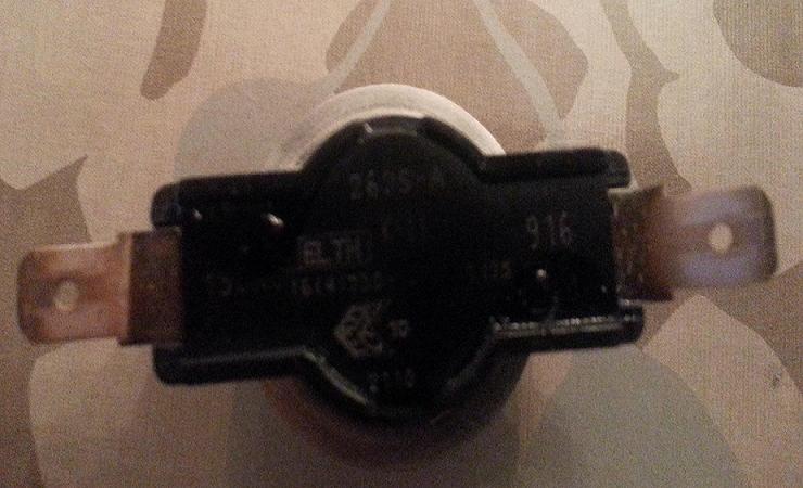

Thank you Eric for the clarification. However the manual reset thermostat on my dryer looks like the picture below This doesn’t look like the part you recommended AP5646585. Are they interchangeable?
Yes, the original Whirlpool part number was 8182502 which has been replaced with W10483239 which is APP part AP5646585.
Eric
