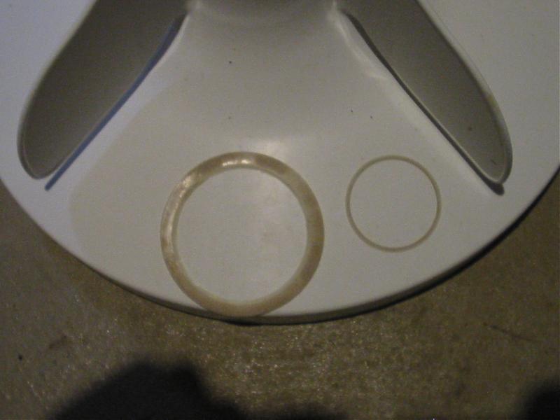

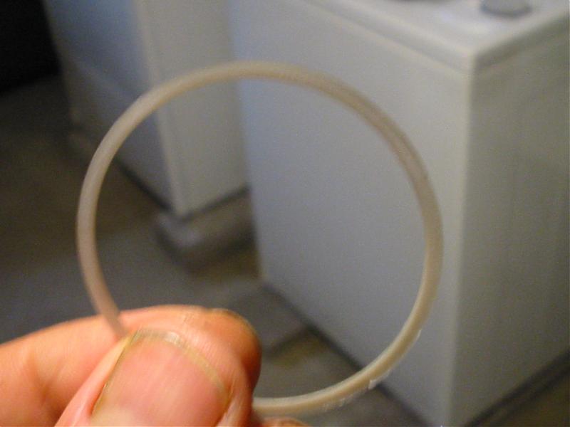

Whirlpool model lsq9549pw2. I am in the process of installing a new Short Cam Agitator Repair Kit Part Number AP3094543. I soaked the entire agitator in hot water because I was having trouble separating the upper and lower agitator. As I went to separate them, I noticed 2 flat plastic washers that came off. One of them has the same part number as the - Thrust Spacer Washer Part Number 3951608, but looks different. I think it could have possible wore down or the tabs broke off. Where does the new Thrust Spacer Washer get installed and where do I install the smaller washer? I posted some pics.
It gets installed on the top of the lower agitator with the tabs facing up. Yours is completely worn out and the smaller washer I believe is just whats left of the inner circumference of the old thrust washer.
