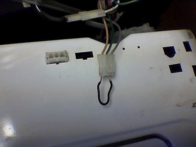

My whirlpool washer model LSQ9645KQ0 will agitate fine. When it changes cycles and is supposed to drain and spin, it only drains. In order for me to get it to spin, I have to raise the lid and re-close it. I have ruled out the switch because I disconnected it from the control panel and installed a temporary jumper in that connection (permanently closed lid condition). Even in this situation, I had to remove the jumper and re-install for it to begin spinning. Could this simply be the clutch?

I’m not convinced it’s the switch. I disconnected the switch and installed a jumper in the connector at the control panel. The attached photo shows the jumper installed in the control panel side of the lid switch connector. In order to get the washer to spin, I had to remove the jumper and re-install. When re-installing the jumper, the washer began spinning immediately. Any other suggestions?
Hello.
You are right. The problem is not the switch. In your case it’s the timer.
Here why - Your washer has a neutral drain transmission. That means - the washer drains first then pausing for a few seconds
allowing the spin gears to engage, and only then the spin starts.
The timer is not pausing which makes the washer drain constantly. When you open and close the lid manually you imitating the pause.

I did some more investigation last night. What I found isn’t much different than you say. When I heard the washer begin draining, I slowly lifted the lid. When I did, I noticed that upon the lid switch releasing and the draining operation stopping, the spin engaged slightly. Then, when closing the lid again, the drain and spin both worked. It appeared that lifting the lid either “reset” the timer as you say or it caused the spinning cycle to engage.
Does this change your opinion of it being the timer? I hate to spend the money on a new timer if it is not the right fix.

After further review, apparently changing the timer did not solve the problem. Maybe it was a coincidence that it worked the first time after changing the timer, but since then it has not worked properly. It is still doing the same thing. It will drain, but not spin. If you lift the lid while it is draining, the washer stops and at the last second the “spin” engages and turns about 1/2 a turn. Then, upon closing the lid, it spins as normal.
What’s next?
