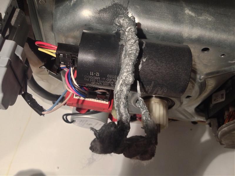

I also noted on the motor what looks like a wire covered in “silver” solder or something. I’ve not seen this in all the pictures or videos I’ve seen when looking at the bottom of machine.[ATTACH]stamps are getting so expensive.
Oh, sh.t I’m out of floppys. See below picture of motor with whatever that is. I didn’t do it and don’t know if it was done with initial installation or not!

That’s a basket speed sensor fault and shifter fault. The speed sensor is part of the shifter and the shifter is a very high failure item with these washer’s. They can test good and still be faulty. I would replace the shifter. The “wire” looks like it is probably a ground that they have added to the transmission case. Probably made with flexible braid and then it gets dipped in galvanizing solution during the transmission case manufacturing process. Just a guess on my part, I have not seen that on these washers yet.

Thanks Eric, I so appreciate this! Just called a repairmen I got from Angie’s List and he doesn’t work on them anymore. He said he was 75% sure it is motor, but I’ve heard what you said before about the shifter.
Probably just order both from AppliancePartsPros and give back motor if shifter fixes it.

Wonder why he doesn’t work on them anymore? Most tech’s consider these Whirlpool belt drives as goldmines because they have so many problems and are easy to work on. May be the high cost of repair parts when many people just decide to trash the thing and get a new one.
If the motor doesn’t attempt to move at all, it could be a faulty motor, capacitor, control board, wiring harness connector or a broken wire in the harness or at capacitor which are common. Broken wires are common at wire tie-down points where they cinched the wire ties far too tight, especially the one between the motor and the coiled up section of wire.
