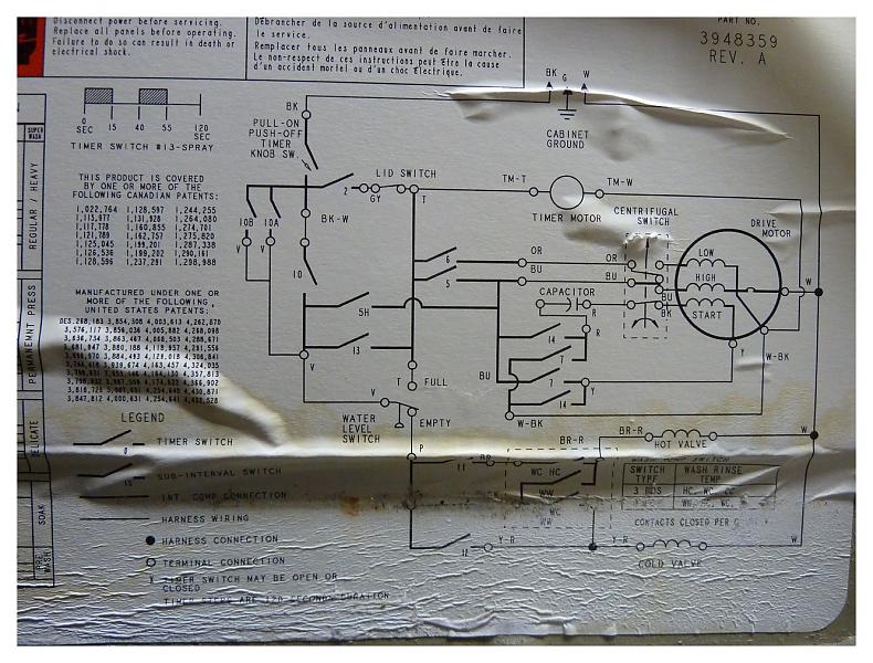

Hey All,
 So my washer motor won't work at all. Had some water in the basement and now the motor won't work at all. It won't agitate, spin, or drain.
Power is going to the timer, the water solenoids work, and when it is on the “spin” setting there is power to the following wires to the plug to the motor: white with a black stripe, white, and red. No power to the blue, yellow, or orange. The capacitor seems to be fine.
Any suggestions on what could be the issue?

The motor connector white and white/black are neutral, red is hot during spin, neutral during agitation. Yellow is neutral during spin, hot during agitation. Does the timer advance when you set it to spin? Does it advance when washer stops filling and should be agitating?
Eric

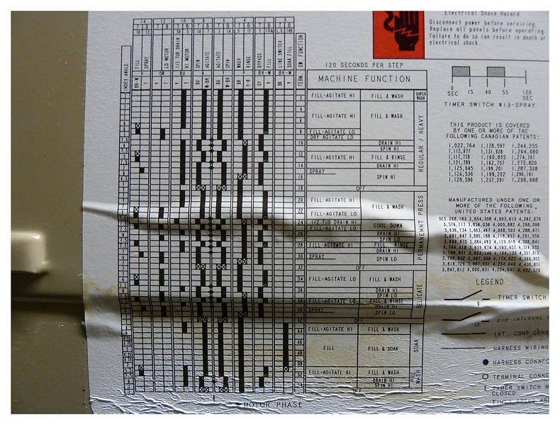

Hmm… True. Attached photo of wiring diagram.
Washer Wiring Diagram 1.jpg (100.1 KB)
Washer Wiring Diagram 2.jpg (111.1 KB)
Ok, nothing fancy, just the standard Whirlpool 2 speed motor no frills wiring diagram. If, when set to operate in spin, you are truely reading 120vac to ground at white wire or white/black wire motor connection and nothing at blue or orange, something is very wrong. Since timer motor runs but does not when motor connector unplugged, neutral appears to be ok. Again, sounds like a faulty timer but any voltage reading on those wires (white or white/black) means there is some other problem lurking. If you are getting voltage on those wires, check it with meter probe in neutral of wall socket vice washer ground connection and see if you still get voltage.

Ok, so here’s the results: Timer set on spin cycle, 120 volts a the motor plug to White, White/Black, and Yellow. No power to the other wires.
This was with the meter to a neutral prong in an outlet, and the same results with it to one of the green ground wires to the washer frame.
Sounds like your receptacle is wired reverse polarity. Makes no difference to the washer as it would still work normally but you need to fix that receptacle wiring before continuing.
Eric
If it makes a difference, I was incorrect, the meter was in the ground of the outlet. Not the neutral.
Does this still mean it’s the timer you think?
You should not be reading voltage to ground or neutral from motor connector white or white/black wires. I can’t say with any certainty if your timer is bad or not based on the readings you are getting. You could try replacing it. If you buy from APP, you may return it if it doesn’t fix the problem. You need to do some electrical troubleshooting and I can’t teach that over this forum. It appears to me that your receptacle is wired wrong. Check voltage on receptacle between ground and the wide blade and ground and narrow blade. Which one do you get 120vac on?
