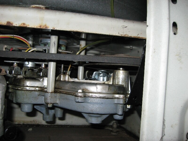

Washer was left on its side and half the gear oil leaked out through a top vent hole. The oil is like thick brown sludge mud syrup so it probably should all be replaced. I guess it could be turned upside down to drain the rest, but how to refill is in question. Can I use thin plastic tubing to drip new gear oil back in through this vent?
What’s the proper method?

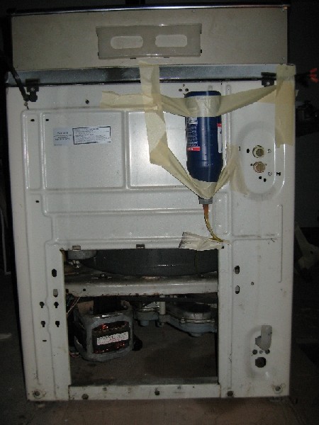

I used automotive 70-80 weight gear oil which I had leftover. Slow dripped overnight. Photos are attached. Good for another 10 years?
washer oil drip 1.JPG (60.4 KB)
washer oil drip 2.JPG (122.3 KB)

I would like to nominate you for the best jiggery pokery award of the month perhaps even the year.
Great fix, I take my hat off to you!!!
I second that nomination
