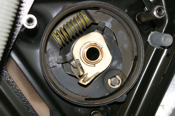

Before removing tranny, turn the tranny coupler clockwise till the spin basket starts to turn. If hard to turn the coupler, you have dragging brake shoes causing the slow spin.

the next thing to do is remove the agitator and then the tranny and inspect this:[ATTACH]284[/ATTACH]The little ear will wear down or break off or their will be brakes locked up as mentioned before.
[FONT=Arial][/FONT]I did not notice any of the ears breaking off. There is no apparent damage to this area of the machine. This picture in the attachment is not very good, but maybe it can help. I tried to move the assembly around, but when I did it dropped out of the casing a little. Is there a way to get it re-aligned? Where do I look for binding?[ATTACH]286[/ATTACH]
