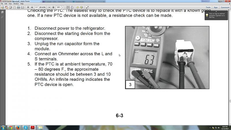

The information below is directly from the service manual published by the manufacturer. That is what I based my diagnosis on.
ScreenHunter_143 Nov. 22 20.04.jpg (55.8 KB)
Then I got a bad new part? I doubt it. Don’t know what service manual that came out of but it’s wrong.

Okay, well anyway, I just wanted to let you know you can return that part and show you how the manufacturers (all of them) recommend testing the PTC relays. I hope you have a great evening.
As a parting thought, that relay is not a wire wound one that will click, as you say you have not heard. The link below explains how the PTC relay works…
PTC Relays | Learn refrigeration
