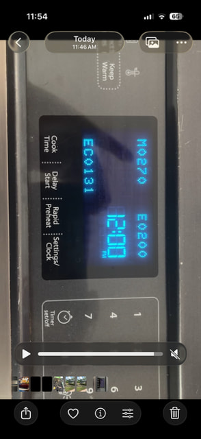

Brand: Whirlpool
Model Number: WEE730H0DS0
Main Symptom: Display Board turns off, can’t bake.
What happens & when: It was intermittent at first, then totally went off
Error Code (if any): M0270, EO200, EC0131
Parts or tests already tried: I already replaced part Part #:
AP6023344 (WPW10603098) but still getting same codes
For your Whirlpool range model WEE730H0DS0, since you’ve already replaced the control board WPW10603098 (AP6023344) and the display is still shutting off, I wouldn’t recommend buying another board just yet.
The fact that the problem started intermittently and eventually became constant makes me suspicious of a loose connection, damaged wiring, or a problem with the control panel’s power supply.
One important detail about your picture: M0270, E0200, and EC0131 don’t appear to be standard Whirlpool fault codes. They may be software or identification numbers displayed during startup rather than actual error codes.

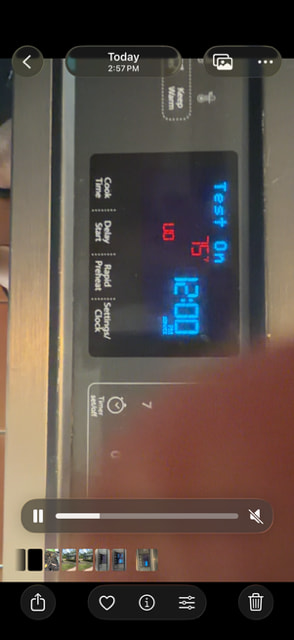

I also did the Cancel, Cancel, Start, but it did not throw any codes. Attaching picture of what it showed.

Thanks for the update! Your voltage readings of 245V across L1 and L2, and 121V and 122V from each leg to neutral, look good. That tells us the range is receiving the proper incoming power.
Since you’ve already replaced the display/control board WPW10603098, checked the wiring, and reset the breaker without correcting the problem, I wouldn’t replace that same board again just yet.
Looking at your picture, the display shows Test On with the time and temperature indicators. That suggests you’ve entered a test or diagnostic function, but it doesn’t necessarily mean the control has passed all its tests.
The important thing now is determining whether the display is losing power or whether another control component is preventing the oven from operating.
