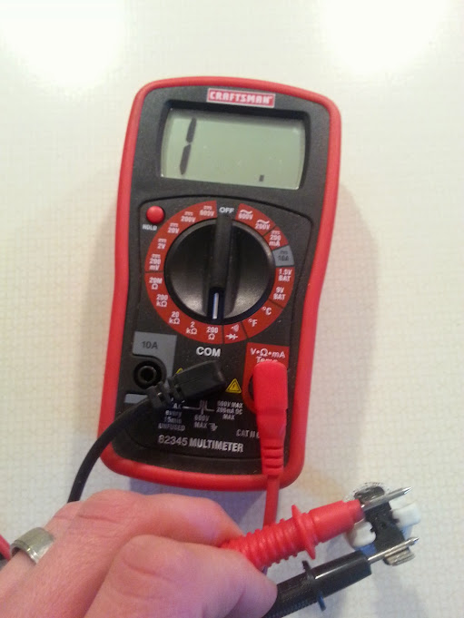

Ok, the switch sounds like it is being activated by the latch. With the switch wires removed, the switch terminals tested infinity. With the switch activated I couldn’t get a consistent reading. At times it would drop near 0, but never reached 0, and sometimes was as high as 10 or 20. This was with the 200 scale.
See picture below of the terminals. One is shiny, the other is not. Not sure if that’s relevant or not.

Yes the switch looks like it is toast.
I would replace it.
Be sure to clean the connector on the wire as best you can so it makes good contact to the switch lug.
