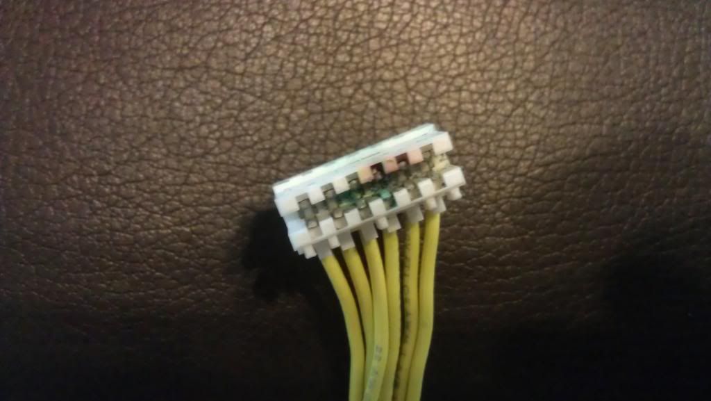

I’m still working on this but I think I may have found the source of the problem. All in all I have replaced, in order, the Control Board W10084142, Control Panel/Pad W10459139, Wiring Harness W10328603, and will be replacing the Turbidity sensor W10134017. After pulling the dishwasher completely out in order to install the new wiring harness, I discovered that the wire
that plugged into the turbidity sensor had been charred and most of the copper from the sensor had turned to patina (green). Water got onto the circuit board within the sensor housing and caused it to short circuit and fry.
– I will admit that this may not have originally been a problem because I did at one point loosen it and reinstall it during my troubleshooting but maybe this problem was present all along; I will never know since I didn’t pay attention at the time. Here’s a picture of the Turbidity Sensor taken apart (I started the scrape the patina off – the copper was completely green before)
I will be replacing this part tomorrow and I will get back to this thread to let you know the outcome. My recommendation is to pull the dishwasher completely out – it’s really not that hard – and take a look to see what’s going on underneath the dishwasher. You can only do so much by taking the door off and laying on the ground looking underneath. If you don’t do this, you might be replacing parts that are working just fine.

Yes, I bought a new wiring harness and I also ordered a new turbidity sensor which will be arriving tomorrow.
I can now report that the dishwasher works and finishes its cycles.
