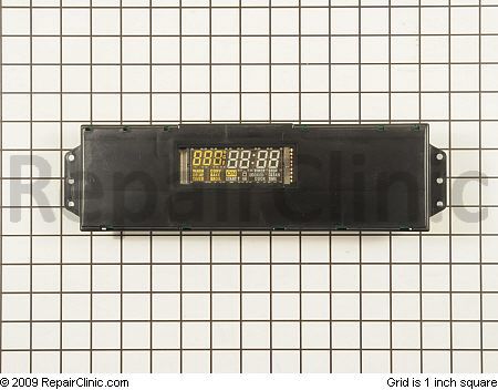

My whirlpool oven won’t turn on, broiler also, everything else works, it has a code F363, I can hear the lock or solinoids click on then off, but no heet. I replaced the temp probe, that did not correct the problem? is this a controller issue?
I think, you mean you have an F3-E3 code, there is no F363 code for your unit(unless you’ve got a bad ERC).
If you have replaced the oven temperature sensor, and checked the wiring and connections from the sensor to the ERC.
Then, YES the ERC is most likely the problem.

I have the tech sheet and the error code presented by the stove is not on the sheet. Additionally, I cannot clear the error code. Never lets me enter mode 1 for manual diagnostics. Whenever I am on the error code screen and hit clock, the display just says good and never clears the code.
According to the earlier post by Joe from App team, he says it is the control panel.

After going through the tech data info sheet, I decided it was the gas valve. I replaced the valve. The oven now works on bake and broil. However, something isn’t right. Strong gas odor when using oven and top burners. Maybe the nozzle that flows up? I can’t find any leaks on the outside connections to the valve.
