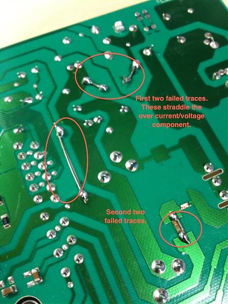

Our Whirlpool Duet HE (WFW9200SQ00) washing machine stopped working with the F28 error indicating a serial communication failure between the central controller and the motor controller. The machine is three years old.

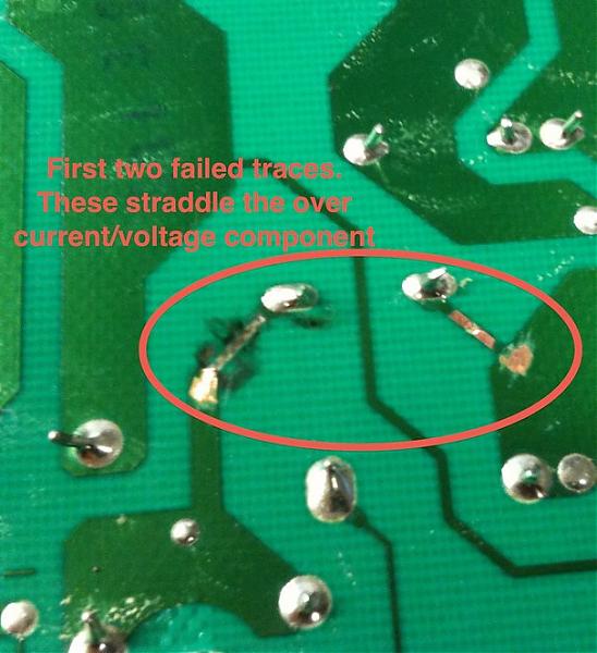

When I took the motor controller board out, I saw that two traces on the circuit board were burned off, or rather, one was burned off, and the other was on its way out the door. You can see where I’d begun scratching off the green in order to repair the traces.
Those traces I easily soldered over thinking they may have shorted out due to water dripping over them or something.
I plugged it all back in and turned on the washer. [COLOR=“DarkRed”][SIZE=“5”]Poof![/SIZE][/COLOR] Smoke and lights.
Upon removing the motor controller I had two new bad traces (it’s like whack-a-mole), and I noticed a bad over current/voltage component – at least I think that’s what the component is called.

The component has two leads and looks like a standing circle. It reads NTC 60. There are more numbers that end in “…35,” but the beginning is blown away.

Here’s a closeup of the bad component:
bad part.jpg (19.4 KB)
The component is a metal oxide varistor (MOV) and is normally open in the circuit. It fails closed, and in my case it measured about 80Ω. I replaced the MOV, and the board didn’t work.
I investigated further and discovered that the rectifier was also bad. I ordered a new one from Digikey and replaced it. Still broken. Sigh.
