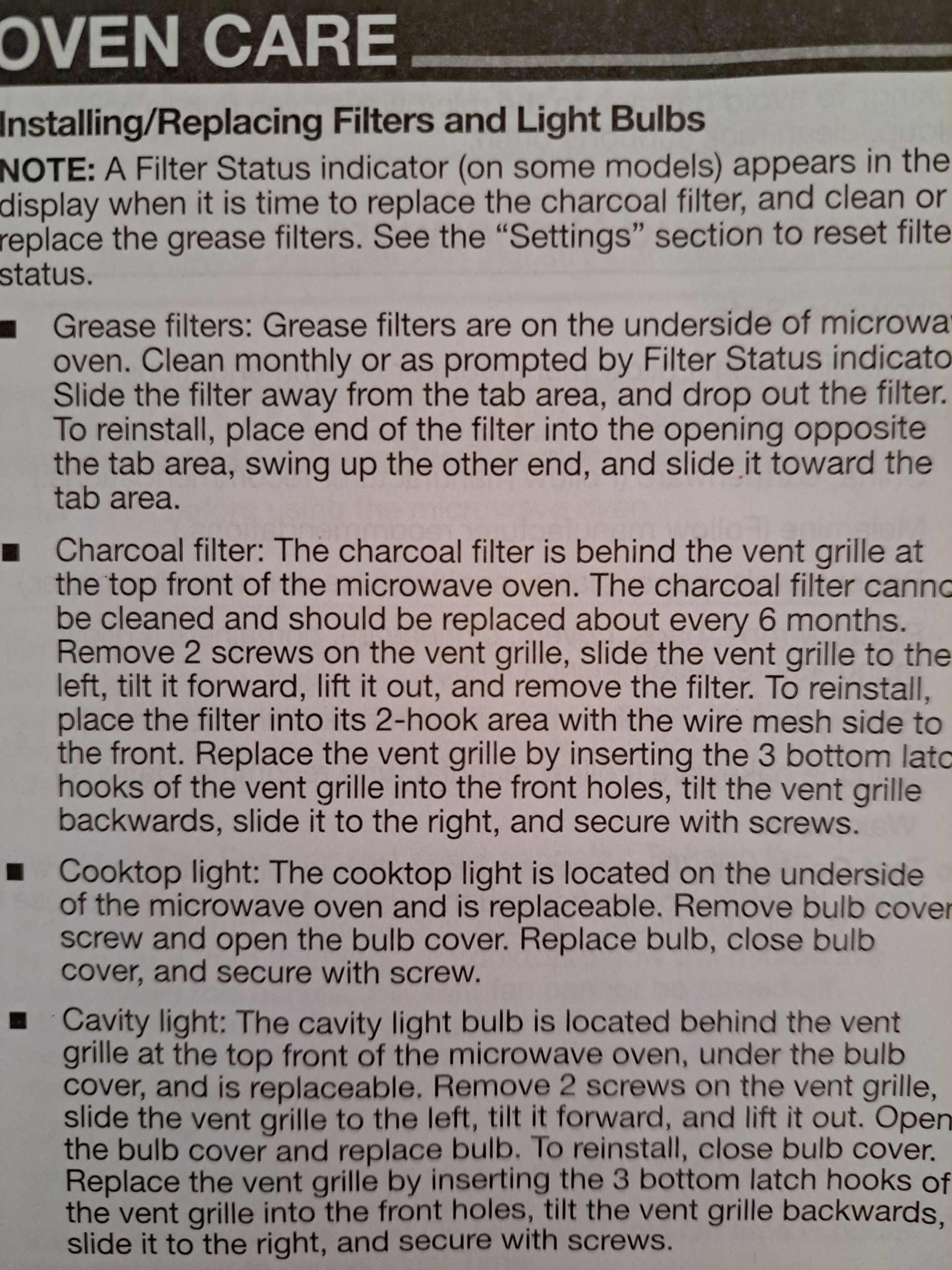

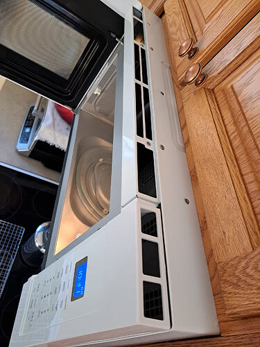

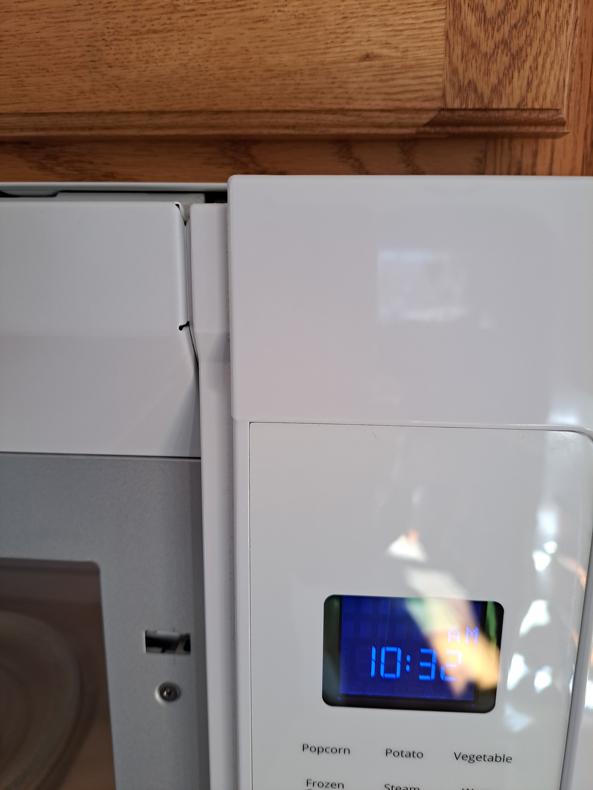

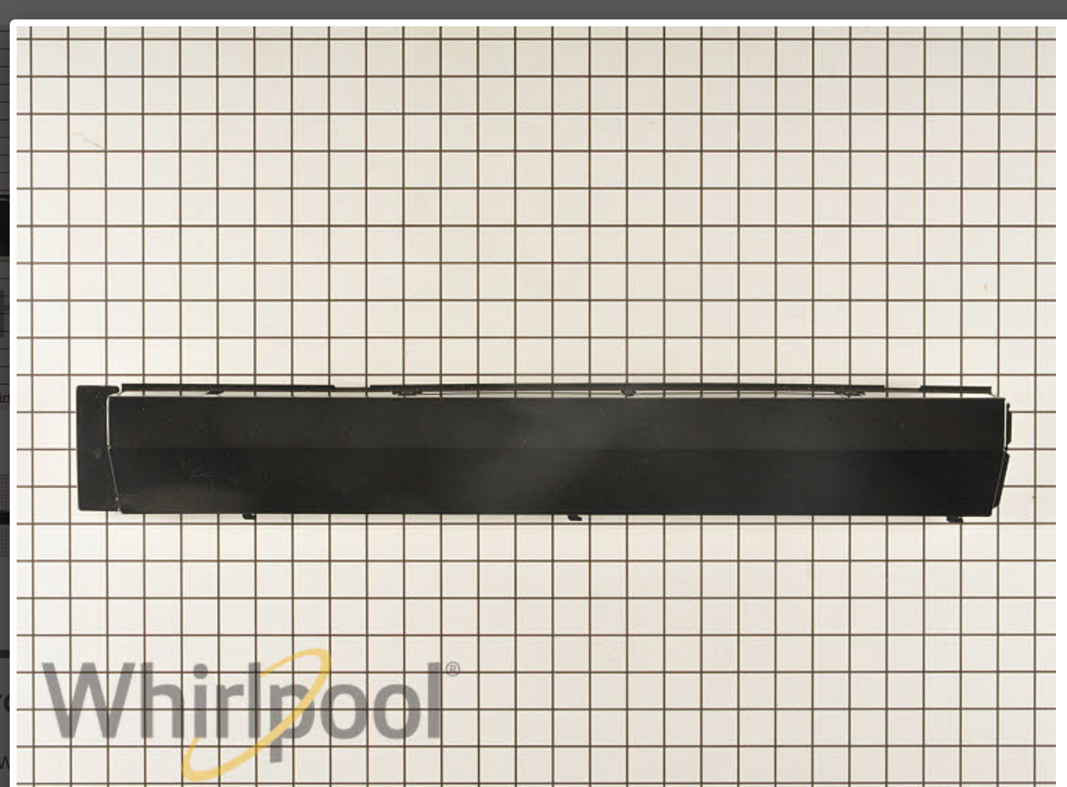

Brand: Whirlpool Model Number:WMH32519HW09 Main Symptom: Filter error What happens & when: Can’t figure out how to remove grill

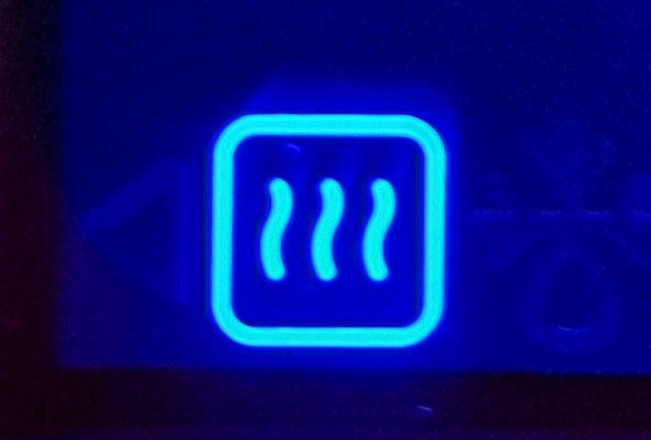

Error Code (if any): Three wavy lines on bottom right of the display.

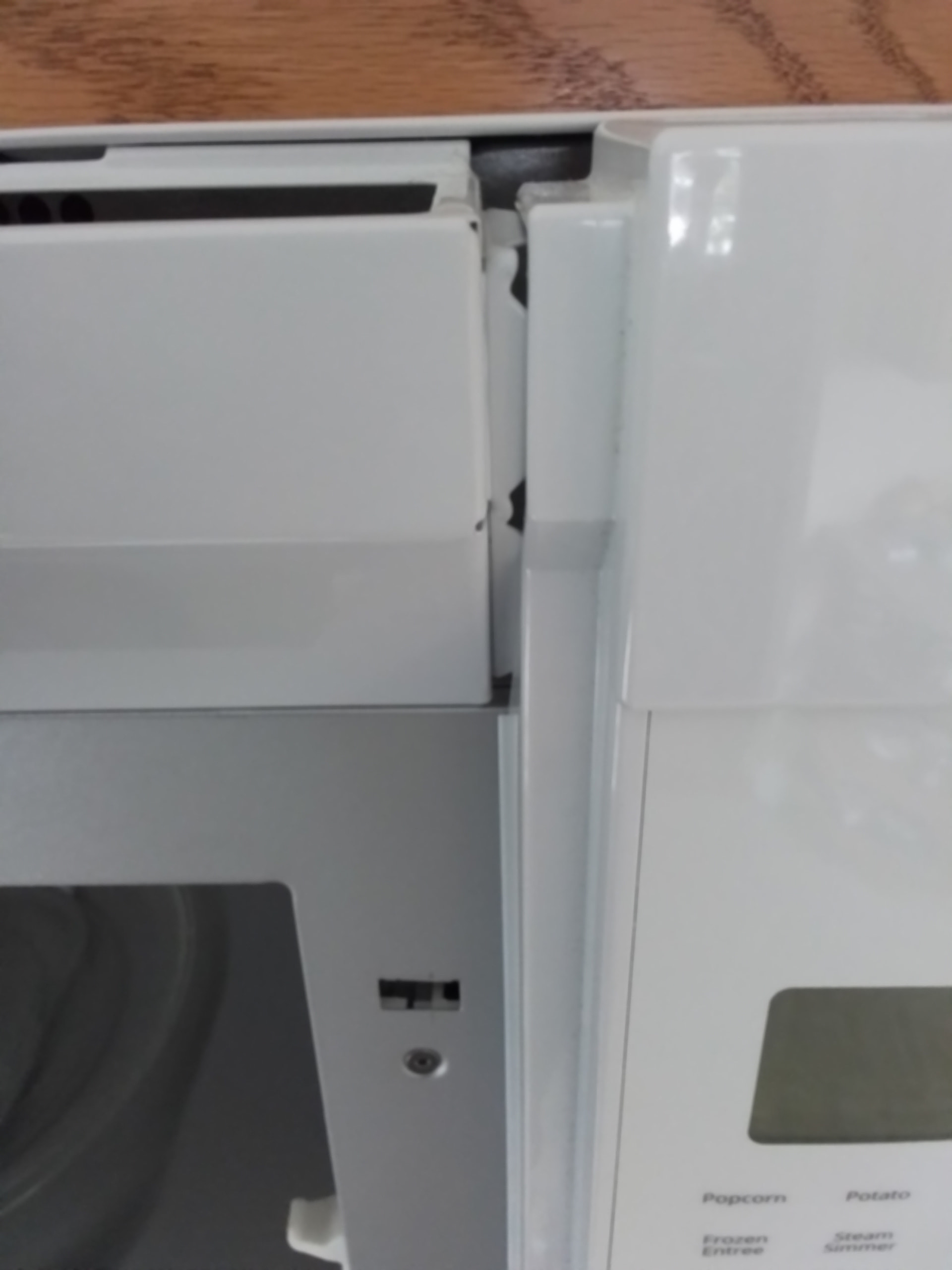

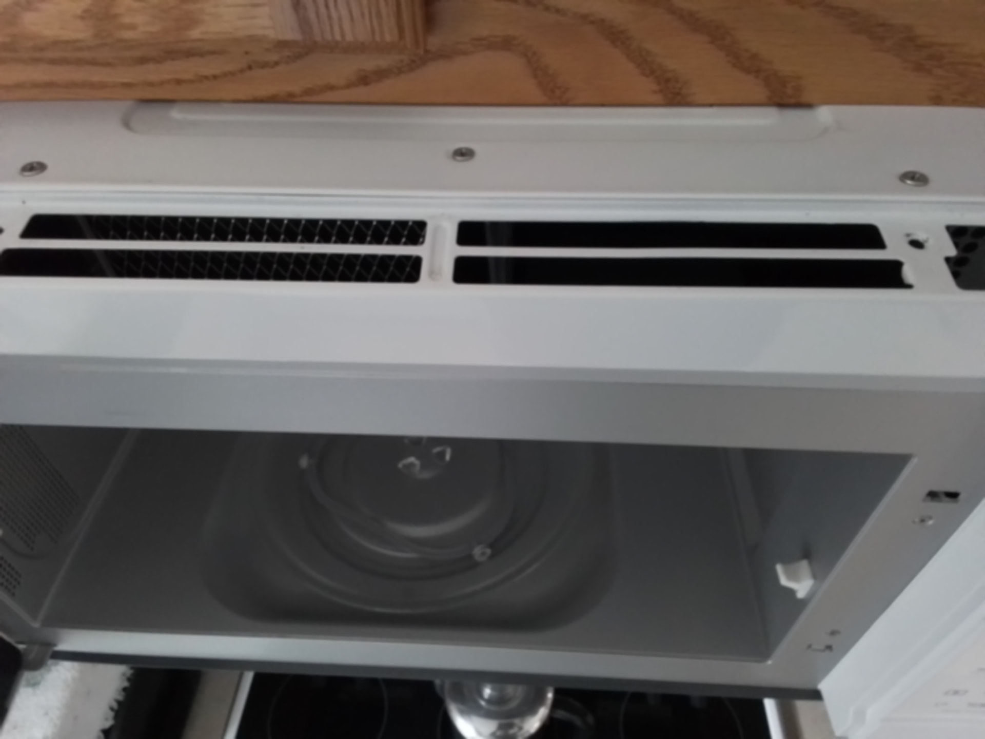

Parts or tests already tried: Tried to access filter by removing screws as instructed , but the grill doesn’t budge.

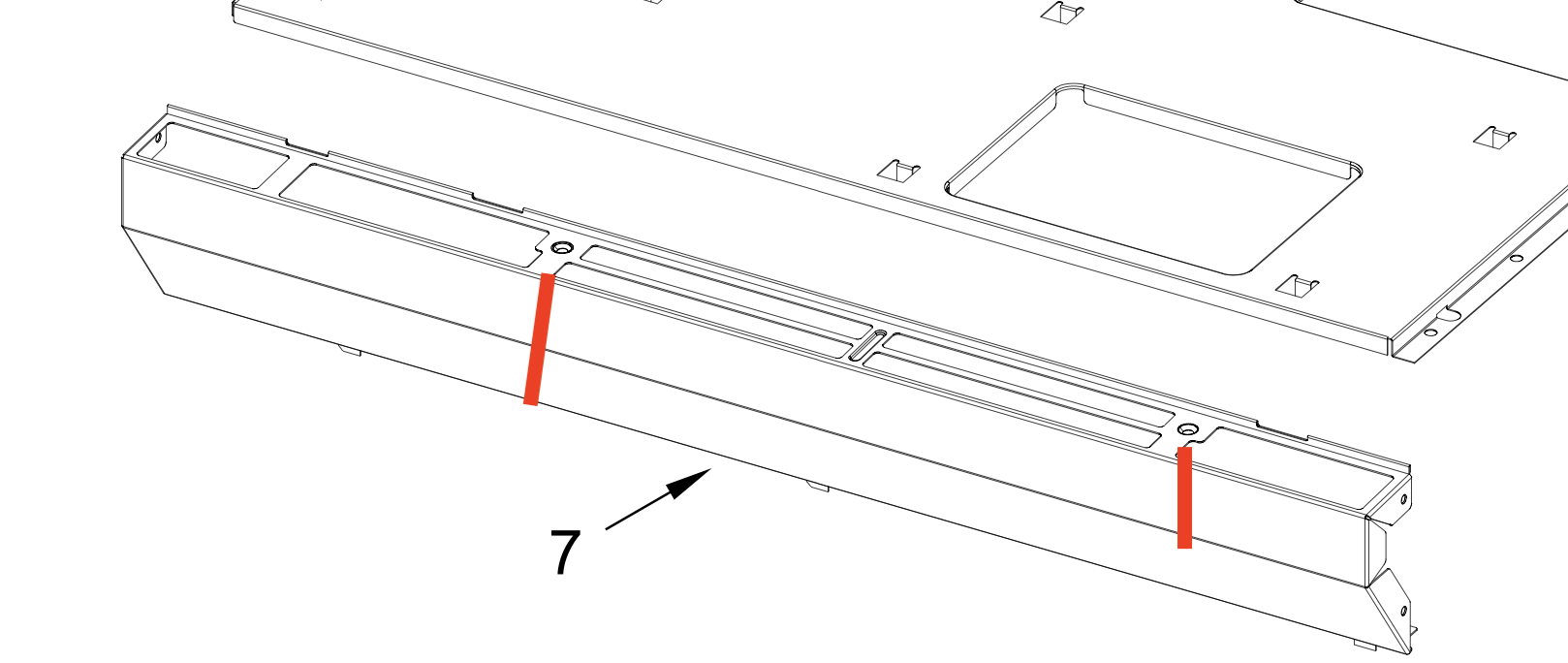

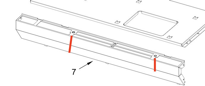

Hello, I see two screws at the top that may be holding the grill in place. Try removing those toward the front of the grill, then slide it to the left and tilt forward.
