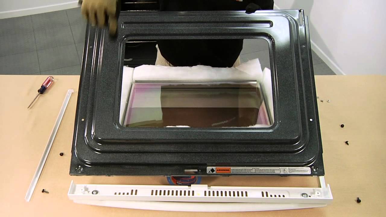

First, we need to remove the door.
In order to get the hinges locked, we have to swivel these little brackets over and into
the up position.
Once you have the door open to the 45 degree position and locked in place, you can lift
the oven door off the body.
This repair will be easier if we place the door on a flat surface such as a table.
Now that we have the door on the table, we can take it apart and do the repair.
In order to take the door apart, we have to remove all the screws that hold it together.
Be careful when you're taking it apart.
As the screws come out, the doors are probably going to fall apart.
You're going to have to remove all four screws on the hinges so later we can remove the inner
door liner.
And then there's three big black screws on each side of the door.
Be careful when you're taking this top one off.
It holds the trim and the handle on.
Once these two screws have been taken out, the handle and trim assembly can be removed.
And there's one screw in the middle that has to be taken out.
We also have to take the side trim pieces off.
You can pop them off with a small screwdriver.
They have a couple pins on the bottom that hold them in place.
In order to lift the inner door off, we have to kind of push the hinges up and then lift
the inner panel up.
Once you have it off, there's a couple tabs in the front.
You'll have to lift the inner panel off the tabs to remove it and set it aside.
Lift the inner metal panel up and remove the hinges from the channels on each side.

When you get the new hinges, they don't come threaded from the manufacturer, so it's going
to be pretty hard to drive the screws in, but you should be able to do it.
In order to put the hinges back in, you have to lift up this metal plate, set the hinge
in the channel.
We're just going to lift up the metal, put it in the channel.
In order to put the inner door panel back on, we have to put the little tabs into the
frame on each side.
As you lower this down, you're going to have to push up on the inner panel that holds the
glass and the insulation, and make sure that you tuck all your insulation in as you go
around, making sure that none hangs off.
We can push this inner panel up a little bit so all the insulation is underneath.
