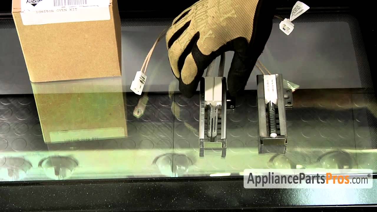

When you open up the package, you're going to get a new oven igniter.
The main reason you'd be changing out the oven igniter is if the element itself shorted
out and it's no longer glowing or it is glowing but it's only glowing red or orange.
These things need to glow white hot in order to get hot enough to let the gas come out
of the safety valve.

Here's the old igniter next to the new igniter.
If you already have one of these, great.
If not, you can get it at AppliancePartsPros.com.
Sometimes when you get these igniters, it won't be an exact fit to your particular stove.
Sometimes when you get the new igniter, it's just going to have wire ends on it, no connection,
but it'll give you a couple of wire nuts.
So what you have to do is cut the connector off the old one, strip the wires, and use
the wire nuts to attach it to the new one.
They do that so they can make one igniter fit many different stoves.
In order to make this easier to put in, we threaded the screws into the igniter.
If yours will go in there and hold, it makes it easier to put them in later.
