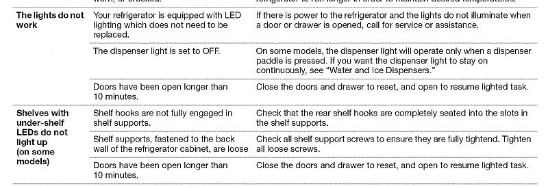

We just plugged in our new fridge couple days ago…and everything worked fine.
Then all the sudden none of.the lights on the inside work…fridge or freezer.
Anyone know what the problem is? Bad door switch?
This is from the owner’s manual.
