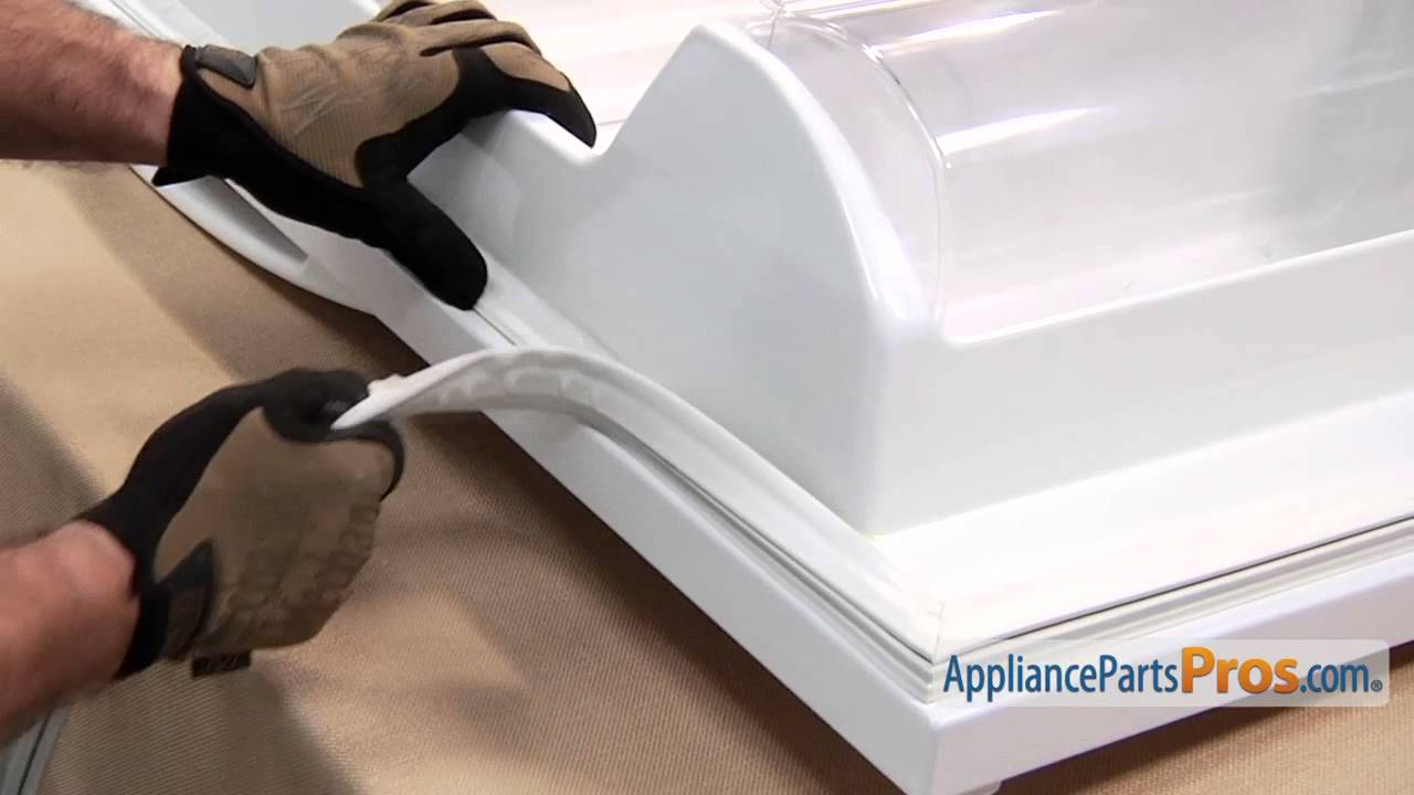

Now that you have the door off the refrigerator, we can set it on a table and get ready to
change out the gasket.
The first thing you want to do is take your gasket and lay it out in the sun or get it
in some hot water to get all the creases and wrinkles out of it.
Sometimes when they ship them, they come with some creases in the gaskets and you need to
get those straightened out before you put it on.
So before we cut the old gasket off and it can't be reused, we're going to lay the gasket
out above the old one just to make sure we have the right one and there's no problems.
So it looks like it's about the right size.
If you do this and you find out you got the wrong one, you just need to give us a call.
While you have the gasket sitting outside or soaking in some hot water to get the kinks
out, we can start to take the old gasket out.
What you have to do is carefully peel it back.
You want to start in the middle of one of the longer sides of the door and you peel
it back and then you can take your wire cutter and snip the gasket all the way into the door
liner.
With the gasket pulled out, we can take our wire snips and snip the gasket until we get
up close to the door liner.
Once we get up to this point, we can very carefully pull on it to get it to come out
from underneath the door liner.
Then once we have it all the way out, we can cut it the rest of the way.
Now that we have the door gasket cut, we can pull it out.
You want to make sure that you pull straight out this way on it.
Don't pull up, otherwise you'll separate the inner and the outer door liners.
They're not made to come apart.
So you just want to pull straight out, work it all the way around the door.
Once you get the old gasket out, you can take a putty knife and put some tape about three
quarters of an inch up and run it around in between the outer door and the inner door,
making sure that you push it in the whole way.
You want to get rid of any of the loose foam or any chunks of foam that might be caught
in this groove that when you try to put the new gasket on, it's going to bind you up and
not allow you to push it in.
So don't go any deeper than three quarters of an inch though.
Here's the old door gasket next to the new door gasket.
If you already have one of these, great.
If not, you can get it at AppliancePartsPros.com.
The new gasket is a little bit different than the old one.
It has this hard plastic edge that actually goes underneath the lip of the door liner,
whereas the old one was all rubber.
So when you're pushing the hard plastic part underneath the liner, you want to use something
that's not sharp and you can press up against this edge of the gasket right here to get
this underneath the lip.
Don't use anything sharp that's going to tear the new gasket though.
And you want to do the opposite corners first.
So we're going to do this corner, and then the other opposite corner, and then the other
two corners.
So with the gasket laid out, we're going to start at the bottom corner over here.
And again, this black piece is what's going to go up underneath the door liner right here.
So we're going to stick it underneath, try to get it started.
And once we have it in there, then we can use the tool to push it up into place.
If you can get it with just your finger, it may be a little bit looser, but you may have
to press on it with a tool.
So we got that bottom side in.
So we're going to finish up this corner and do this edge a little bit up, and then we're
going to go up and do the opposite corner.
All right, so we're in the upper opposite corner.
We're going to get the black piece underneath the door liner and get it started.
And then we can do a little bit going up this way.
Your gasket seems a little bit short.
Sometimes they stretch a little bit, so you might see them and it looks like it's really
short.
If it looks like it's a half inch short or so, all you have to do is stretch on it and
it'll stretch out a little bit.
All right, now we'll go down and do the other bottom corner and then come back up and do
this one.
Now that we have the corners in, we can use our tool and go around the outer edge of the
door and put the rest of the gasket in.
