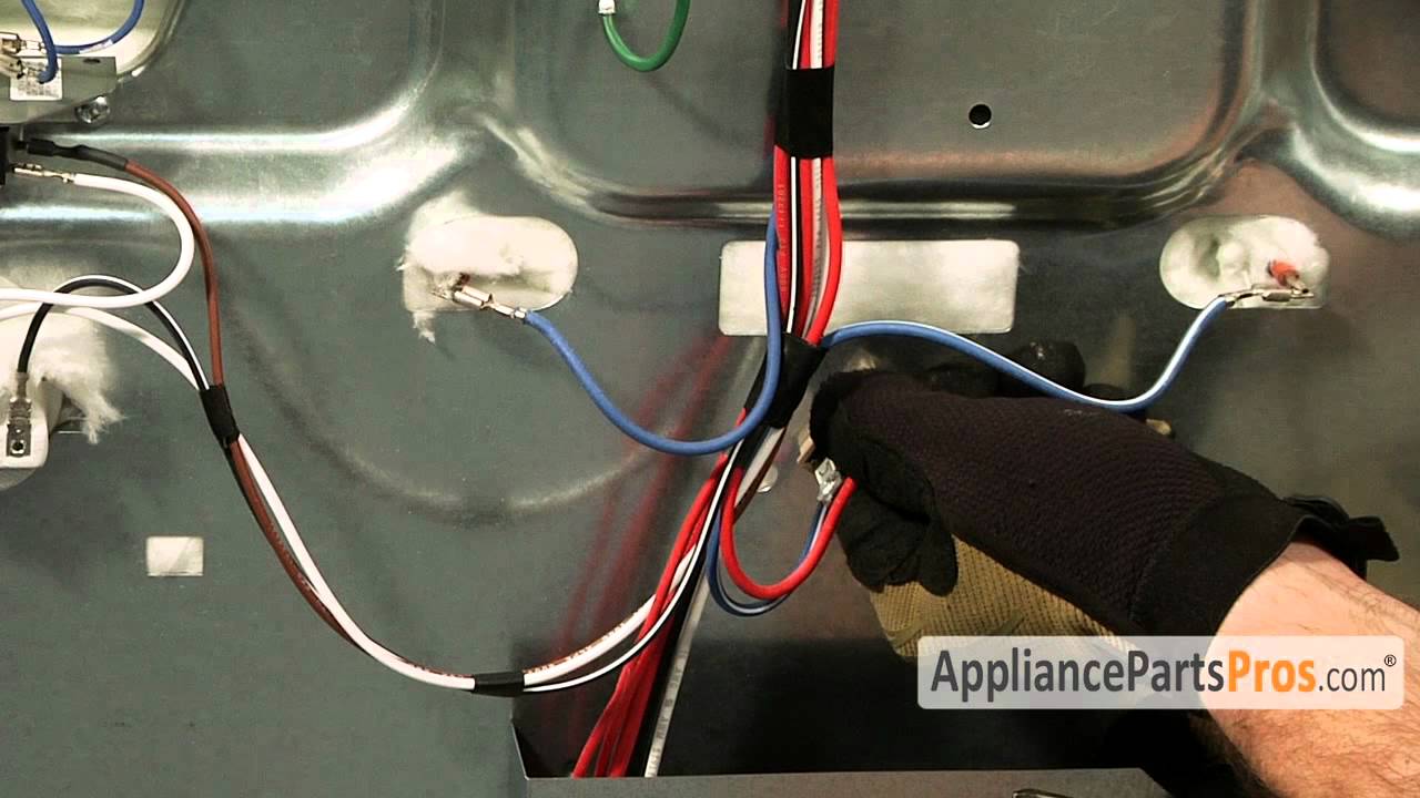

In order to change this part out, we have to remove the back access panel of the stove,
so we need to remove all these screws.
Once you have the screws out, we can go ahead and lift the panel off.
In order to change the thermal fuse out, we have to disconnect the two wires
and remove the Phillips screw that holds it in place.
Here's the old thermal fuse next to the new thermal fuse.
If you already have one of these, great.
If not, you can get it at AppliancePartsPros.com.
To reinstall the thermal fuse, we have to put the screw in and mount it to the cabinet.
There's a little pin right here that goes right in this little hole to hold it where it's supposed to go.
Once we have it mounted in place, we can reconnect the wires.
This is just a thermal fuse, so it doesn't matter which wire the terminals go on.
Now that we're done with the repair, we have to put the back of the oven back on.
The top goes into this tab right here,
and the bottom has to go underneath this other panel at the base.
Once you have it lined up, you can put the screws back in.
