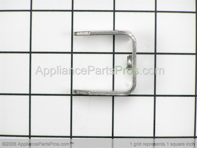

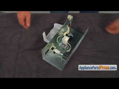

Trying to replace my auger motor for the refrigerator above and cannot get the u-shaped auger arm off. I know it’s reverse-threaded but it simply spins on the auger motor rod. Any idea how to get this off?
Sounds like it is stripped and also will have to be replaced. Try bending it so it breaks off.
LINK> Ice Auger Drive Bar
LINK> Auger Motor
Both links have video helps.
