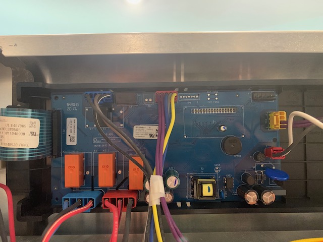

@ William…fm warmer drawer SN is WFE515S0JS0…to all tech pros here: should I order and replace the control board? Recall: temp sensor already replaced with OEM…don’t want to spend $190 if I would be replacing the wrong part. Thanks in advance!

Yes: WFE515S0JS0…also attached is the back of the control board
Good job! :slight_smile:

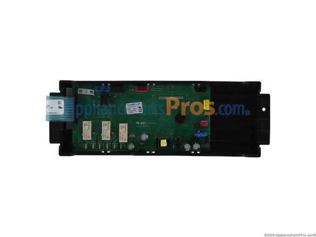

LINK> Whirlpool Range Control Board OEM Part
