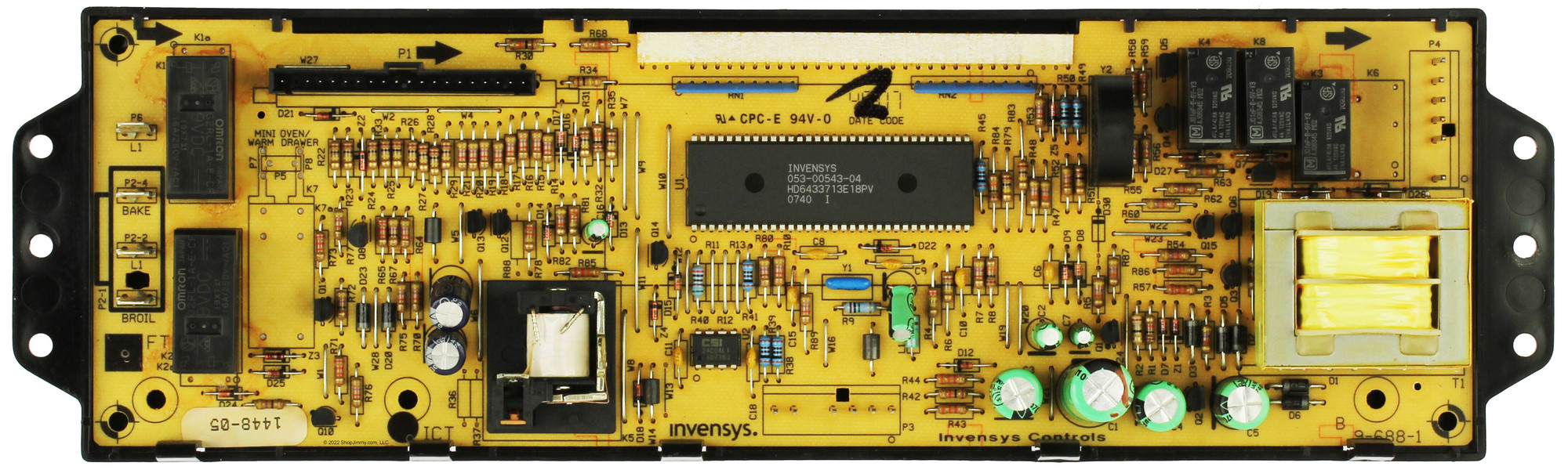

My best guess is its probably a bad relay on the control board. The relay’s contacts get burnt and make poor or no contact and often get very hot. Hot enough to un-solder them from the board or burn the board where they are attached.
If you are good at soldering, you could just replace the relays that are bad. Otherwise you’d have to replace the board. Your model number is missing a digit. Should be a 0, 1, or a 2 at the end of it.
GR563LXSS0 or GR563LXSS1 or GR563LXSS2
For GR563LXSS0 this is the part. Not cheap looks like $354

Thank you. I was concerned it might be the control board since everything else seemed to check out ok. I’m not great at soldering but I have a good electronic soldering gun and have successfully soldered diodes, capacitors, and other components on a few boards. I would probably attempt the repair. I doubt that I can repair it but if the board is not useable as is I see nothing to lose by trying to repair it. That, of course, is assuming I can find the bad relay. I think finding the bad relay will be harder to do than the soldering. Any hints/tips on how to locate the bad relays and where do I get a new relay. I would have to order it. We used to have a really good electronics store in Anchorage that had tons of electronic components as well as a repair person that would get interested in anything you might want to repair and give tips how to do it. Unfortunately they closed during the Covid pandemic.

You’ll need to check your board, but if its the same one in the picture then the two rectangular black boxes on the left are probably the bake and broil relays. They have OMRON printed on them. There is a part number on these G2RL-1A-E-CF . 9VDC is the coil voltage and 16 amps / 250 VAC is its rating.
You can get these from a number of places, ebay or Digi-key, etc.
https://www.digikey.com/en/products/detail/omron-electronics-inc-emc-div/G2RL-1A-E-CF-DC9/1789804

Thanks again for the information. I attached a photo of the control board on my range together with the photo your provided. It looks like a match. The upper relay on the left side probably goes with the bake element.
Tomorrow I’m going to the parts place here in Anchorage that has Whirlpool parts. If he has a relay in stock I will try fixing it. Otherwise I think I’m going to buy the replacement control board so my wife can have her range back and then try to fix the old one to see if I can do it. I found a place online that sells the control board for $229. It’s supposed to be an OEM part.

I doubt your local guy has the relay. I would order two and replace both. If you feel better about just replacing the whole board, then that’s what you should do. Good luck with it. I hope you can get it fixed.

The first photo compares the control board on my range with the photo you posted.

I replaced the oven control board tonight. The bake element and the broil element both work. I put the oven in Pre-heat mode at 350 degrees. After 5-6 minutes the alarm said the oven was pre-heated but the oven thermometer said the temperature was only 150 degrees. I waited and eventually (12-15 minutes) the oven temperature reached 35o degrees. Other than the time difference everything seemed to work ok. Is that time difference significant? Does the oven need calibrating?
I looked the old control board over. The bake and broil relays (K1 and K2) showed some brown residue/discoloration around them. Is that an indication they are damaged? One of the modules on the far side of the control board (k3) also showed some brown residue around it. I will try to replace all 3 if I can find them.
