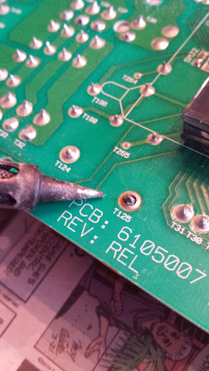

Problem solved! Replaced the upper oven DLB relay on existing board for $10, rather than replace entire board for $300-ish. :smiley:
Longer story & recap: After testing the thermal fuses, heating elements, and temp sensor, it had to be the control board. With everything else functioning normally, and no error codes, I figured it had to be a bad relay (DLB, double line break relay) for the upper oven. Pulled the board and saw slight melting of plastic around one of the terminals on the relay (topside) and melted solder on one of the pins (underside; shown below):
This usually ends in a new control board for around $300. I found a service online that will test, repair and warranty the board for $150. Great deal! Then I did a quick search on the relay itself using the part # on the relay body, and found they cost THREE DOLLARS. Add $7 for shipping. I desoldered the bad relay, and soldered in the new relay. FIXED. :slight_smile:

For anyone who’s a bit DIY inclined, this was an easy job. Diagnose all the parts with multimeter, and if its the board and traces to relay (there could be physical evidence of excessive heat on the relay itself to make it easy to diagnose and confirm) you can DIY. Board is easy to remove, and only 4 pins to uninstall, reinstall the relay. Of course basic soldering skills required but not hard to learn.
