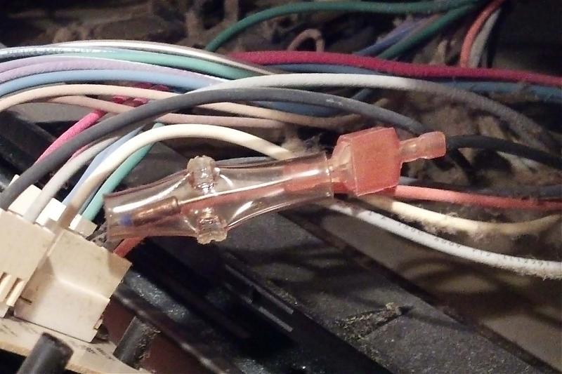

My issue: Used the Auto Clean. Everything shut down an hour or so into the cycle. Door locked and display blank. I let things cool off and turned off the circuit breaker for about 15 min. Reset breaker with not effect.
Found the forum and tried to find the thermal fuse to see if that might be the issue. Found what I think is the fuse but it does not seem to be blown. See attachment. So is this the fuse? Is it blown? If it looks ok, what is the next thing to check?

Yes that is the thermal fuse.
You have to measure it with a meter to tell if it is blown.
Should be 0 ohms.
If you do not own a meter, I would suggest you purchase a one. You can get a decent digital multimeter for under $20.00. You do not need fancy though it is nice if the leads are a couple feet long.
If it saves ordering one unnecessary part it has paid for itself and you end up owning a useful tool.
Most places will not let you return electrical parts so if you order it, you own it.

This is probably a real dumb question. but where to you put the leads when measuring. Referencing the attached picture, I took the connector off of the right side. but I am not sure where to put the probe on the left side. the left side is attached to the control panel. Does touching the cylinder thing work?
You measure from the right hand side connector to the wire that runs to the control board connection.
FYI: The fuse wires must be between the meter leads.
The left side wire looks a little cruddy so you may have to scrape/sandpaper it a bit to get a good connection to the meter lead.
Measuring to the fuse case is no good.
Thanks for the quick responce. I cleaned the wire and got and infinity reading. So the fuse needs to be replaced. I tried to gentle disconnect the fuse from the control board and it doesn’t seem to want to come lose. I didn’t want to force it.
If i replace it and it still doesn’t work, what are the next steps?
I think this is the fuse you need but double check with the parts people.You will need your model number.
AP6009502
There is a pin that holds it in place in a plastic casing. Use a small flat head screw driver to push the pin flat to loosen it from the casing.
