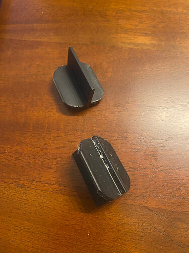

Whirlpool dishwasher will not fill
Brand:Whirlpool
Model Number:WDF320PADS3
Main Symptom: Will not fill with water
What happens & when: I have trouble shot dishwasher. No continuity with fill valve. If no continuity then valve bad correct?
Parts or tests already tried: Neg Continuity on fill valve.

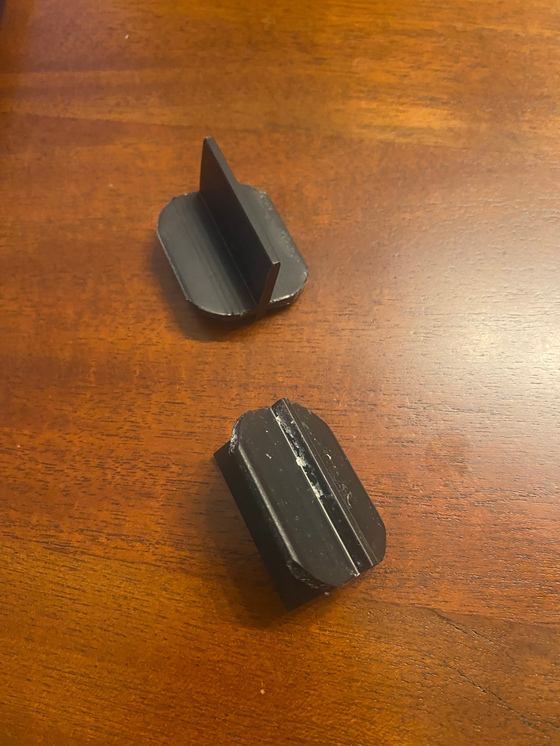

Photos / video link: also these 2 black plastic pieces came out from inside when i righted it. No idea now where they go. Look familiar?
That fill valve W11175771 should read about 890-1600Ωs.
https://www.appliancepartspros.com/whirlpool-valve-inlt-w11175771-ap6339872.html
As for the tabs, I’m not sure on those.
