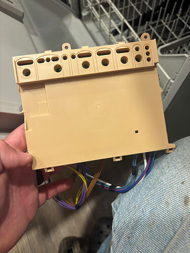

Whirlpool dishwasher WDF331PAMS0 control board
Brand:whirlpool
Model Number:WDF331PAMS0
Main Symptom:bad control board
Old control board with holes plastic stems go into
What happens & when:start button doesn’t work, starts on its own spontaneously
Parts or tests already tried:new control board has no holes in it. Existing (bad) control board has holes in it that plastic stems from the external buttons mechanically push a button on the old control board when you push the button in.
Which part number did you get? The part # you need is ( Whirlpool W11613566 Dishwasher Electronic Control Board (Main Control) | Genuine OEM Part )
I got AP6832570, that said it was compatible with my model number and support also told me was the part number I needed
I am very sorry you were advised on the improper part, It does show both types for your dishwasher, but now that I have the picture and description you sent , i can identify the board you need. Have you tried to install the board you got from us? Cancellations & Returns - AppliancePartsPros.com
