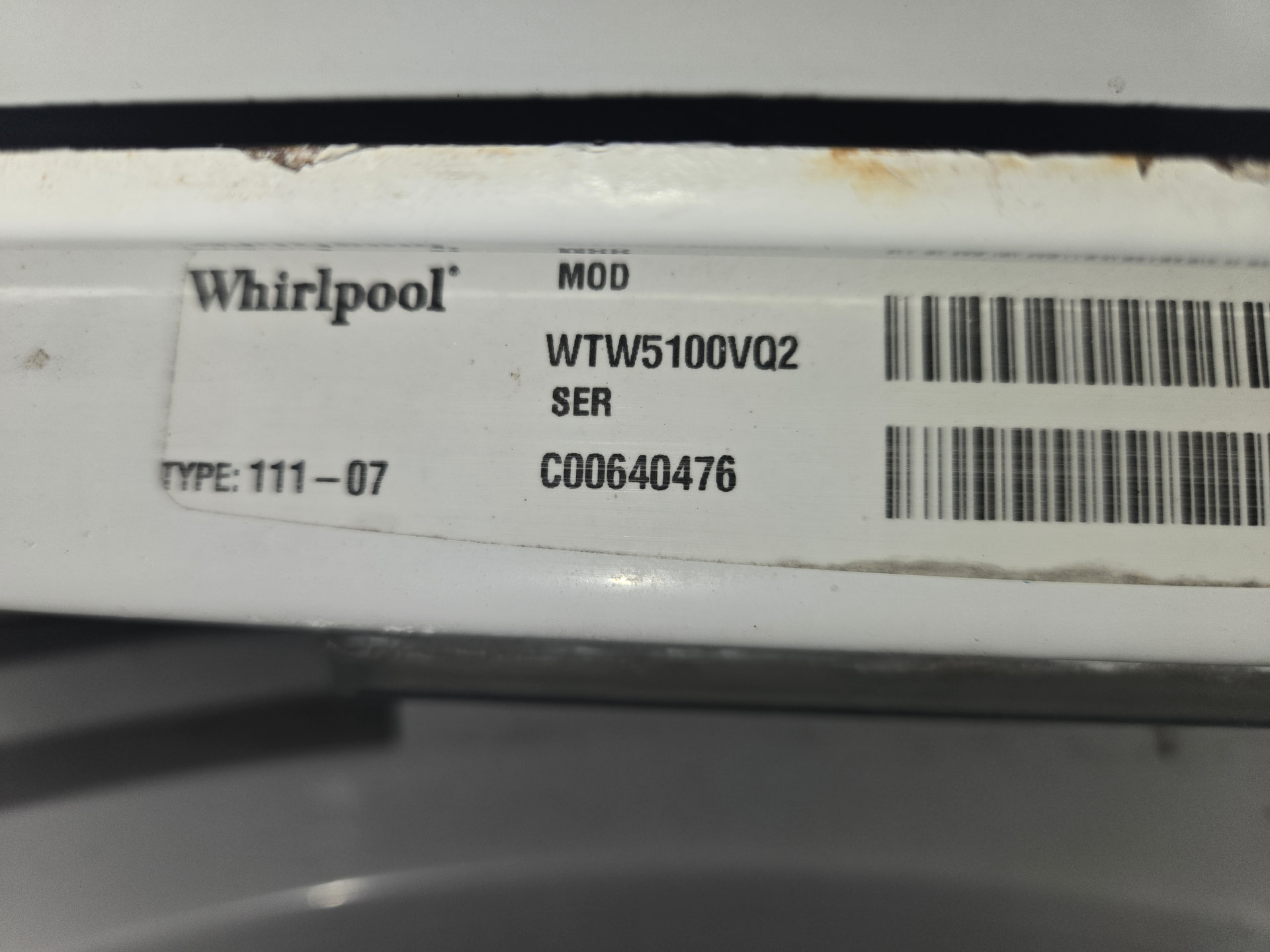

Can u provide me with the model # of your washer
I can’t find a sticker on it. I tried to upload a video, but it won’t let me. This is the unit.
The sticker is under the back edge of the lid on the lid opening I can see part of it under the back edge of the lid
You’re right.
