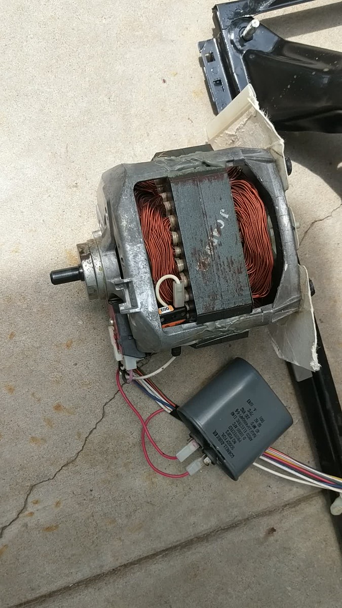

Whirlpool Direct Drive Washer GSX9750P Pulsing-Cycling Motor RPM
2004 Whirlpool Gold Ultimate Care II Washer. 3-speed motor and all the bells and whistles.
Washer was in good shape when bought a year ago so I did not go completely through it. It worked very well for a year.
PROBLEM
Video link to the problem:
This is proving to be a challenging problem!
This washer uses the 3-speed motor 8529935. The motor acts like it is starving for current so it can’t reach phase-synchronous rpm. Instead, it cycles between start-up and running windings as determined by centifugal mechanism rpm.
The more loaded the motor is, the faster it cycles. The video show the problem out of the washer on the ground, but it’s the same in the washer, and it happens in every part of the wash cycle.
ELIMINATIONS
  • Muticonnector terminals. All were checked and found tight and clean. The appliance reseller had changed out one of the terminals as it had gotten hot (then it worked fine for a year). The connections all look great.
-Capacitor was changed to another, a 40 mF, with no change in symptoms. Have a new capacitor coming.
-Timer 854379 C. Complex, 3-connector timer with A LOT of contact fingers! Most are straight. A few are pre bent. One seems bent too much but I did not change it, thinking the manufacturer intended it that way. I found several of the point contacts carboned up a bit. I cleaned them with 400-grit emery paper. No change.
-Two different motors were tried and both cycle the same way.
-Gearbox, excellent, fully functioning, and now with fresh oil.
-Pump, the pump was pulled off while the motor was cycling. The cycling rate slowed as a result of the small reduced load, but was not eliminated.
-Motor coupler is undamaged and tight.
-Wiring harness crimp connectors. Check and compressed them all. No change.
-Other connectors. All were checked and the terminals lubed. No change.

I can add that I’m seeing 20-40 volts on some terminals, unloaded, motor un plugged. Is that possible on a single phase AC system? Should not all wires have either full line voltage or not? Maybe a few volts inductive, but either one or the other?
I will answer this myself because after 2 weeks of working on and off on the problem very deeply, I solved it. As suspected, it was a very simple problem that manifested as complex (as they so often do). I went deeply into every component in a process of elimination, including timer disassembly under a microscope (no kidding).
The problem was no SUSTAINING power to run windings in the motor. A number of connectors on the timer were low instead of high, having only inducted current creating voltages and no full line voltage. Tricky voltages like 20 to 60, not just 4 or 6 or something that low, making one wonder how the heck was that possible?
Complicating matters was this machine is a 3-speed washer with 'Whirlpool gold, super capacity plus (thus the S in the model number), 27 cycles… catalyst cleaning action (thus the X in the model number), 6 speed combinations, etc, blah blah. That means a complex time and a gaggle of wires.
Another complication was I’m not sure I ever pegged the right model number, GSX9750P It was very close, if not right. G = Gold, S = super capacity plus, X = catalyst cleaning action, and P = model introduction year 2003. The Whirlpool model and serial was on a paper sticker instead of a plate and I stupidly blew that away with the pressure washer back when I first bought the machine. Not just blown off, but obliterated. Also, the wiring schematic was left out before I bought it. I did find schematic 3955342, which was close but not my model. It helped a lot in diagnosis.
The major complication, perhaps, is that I am not an experience washer repair guy. I had to learn that a lot of wires go from the timer to other things and back, including down to the motor and back. And depending on timer position and fabric select switch settings (controlling motor speed settings), what the many wires are doing changes.
One critical circuit goes from the timer to the motor and passes though the start switch and returns to the timer, powering a number of downstream things. That depends on start switch setting, whether down or up depending on the centrifugal start mechanism (the click when the motor slows down).
The critical circuit powers the run motor windings… all three of them. The orange with blue-stripe wire (OR-BU) sends power down to the motor when the timer enables it. After the start winding spins the motor up enough to move the start switch to the run position, OR-BU power is routed through a switch contact back up to to the timer via the blue with orange-stripe wire (BU-OR) which powers up some reed switches in the timer and terminals on the fabric select switch. Among other things, this powers up the solid blue wire which sends power to the high-speed winding down in the motor such that the motor doesn’t slow back down and cycle again into start mode.
The entire problem was the copper wires having burned in half in a tiny gap right at the Molex terminal blade at the motor on the blue with orange-stripe wire (BU-OR). This burn through was not visible, and the gap was so small you could not feel it easily. I found it finally by tracing the complex power circuits from the wall cord to the motor, which of course took a few trips between the timer and the motor. This was from my inexperience, as I should have gone the other direction with the diagnosis.
