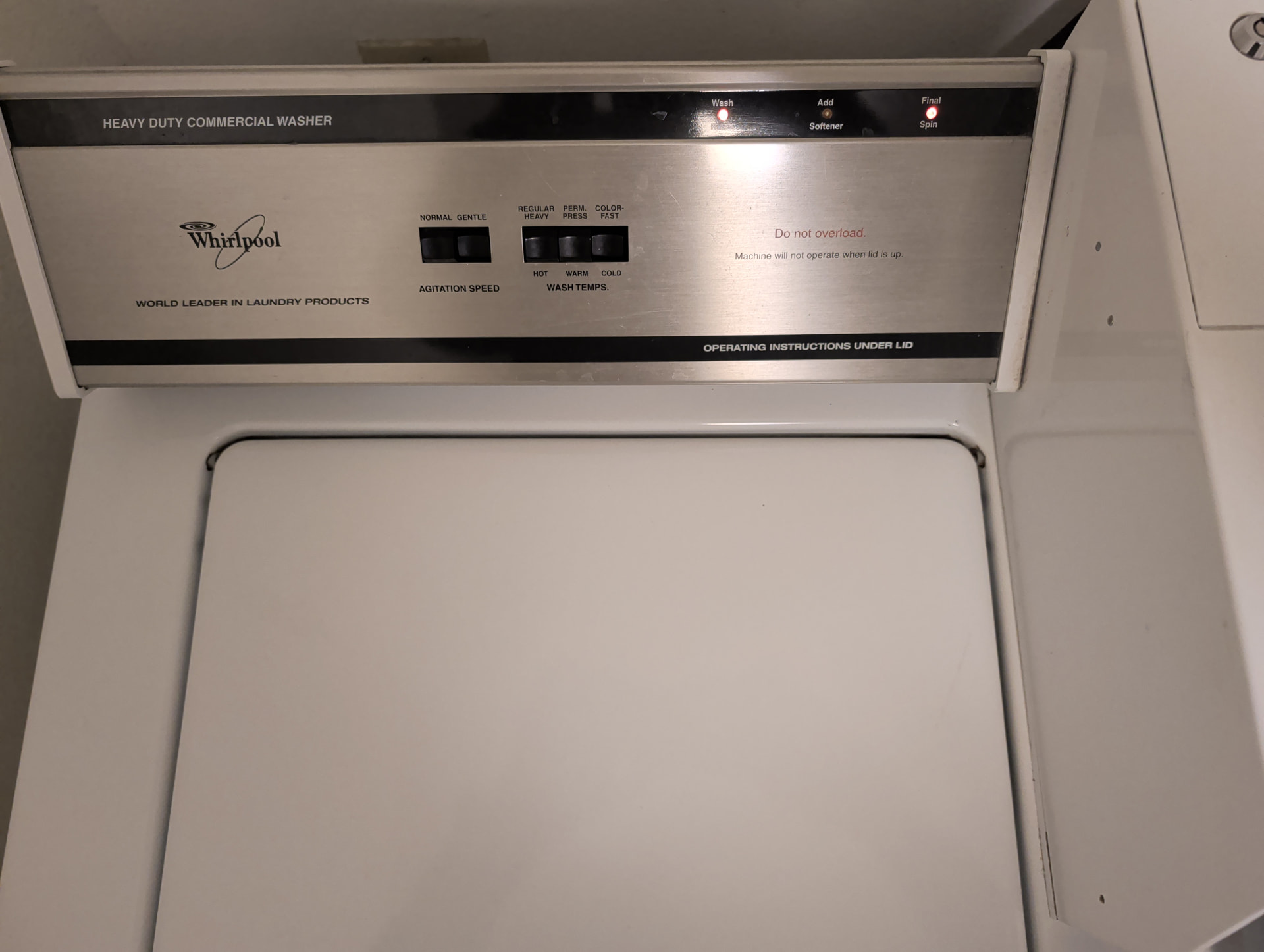

Whirlpool Clothes washer doesn't work
Brand:whirlpool
Model Number:cam2752kq0
Main Symptom:nothing is working
What happens & when:washer is half full of water now. Won’t fill. Won’t drain. Won’t hum. Wont agitate. Lights light up as I turn the mechanical timer but nothing. Just noticed my timer doesn’t advance.
You will want to check to make sure that there is power coming off the timer to the motor and to the water valve. If there is power then the timer is faulty. Based on what is going on it sounds like the timer may be the issue.
