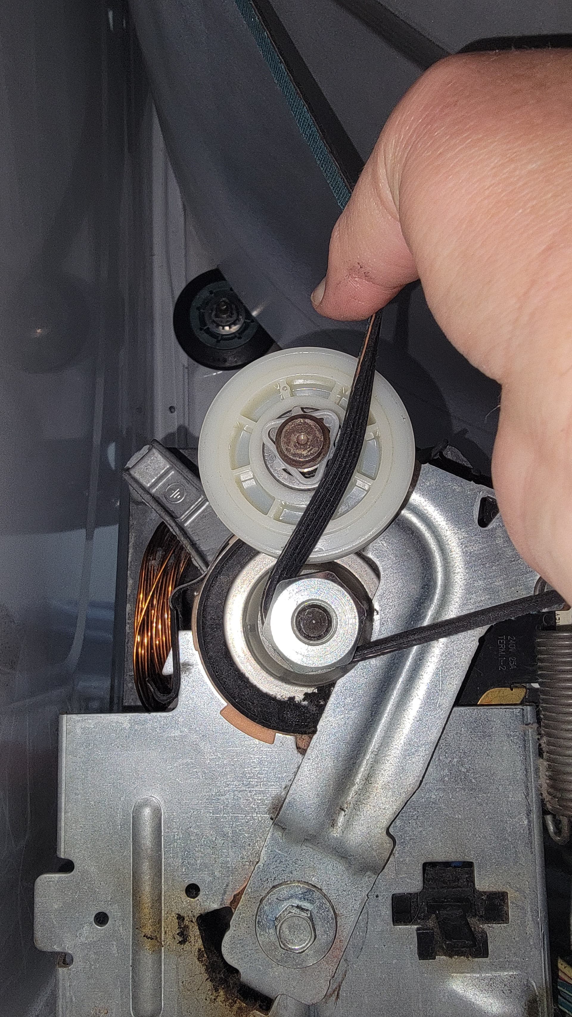

Main Symptom: Can’t get belt on
What happens & when: too tight/no slack
Whirlpool Cabrio model WED7400XW0 replacing belt and rollers with kit 4392067RC. For the life of me, I cannot get the belt on the pulleys. There isn’t enough slack. Even with the tension pulley’s spring unattached there isn’t enough slack in the belt to loop over the drive pulley and tension pulley. Picture attached.
Am I doing something wrong? It seems I ordered the wrong part but I thought this was the correct rebuild package. Any thoughts?
Should I just buy another separate belt?
Thanks,
Chris
Parts or tests already tried: 439067RC
The maintenance kits don’t always have every compatible part and it is common to run into this. The belt you will need is a little bit bigger. WP8547157 Drum Drive Belt | Genuine Whirlpool OEM In Stock
Thanks man. That’s what I was guessing. I was suspicious when the rebuild kit was $35 and the belt alone was $45. I appreciate it. I thought I was losing my mind.
