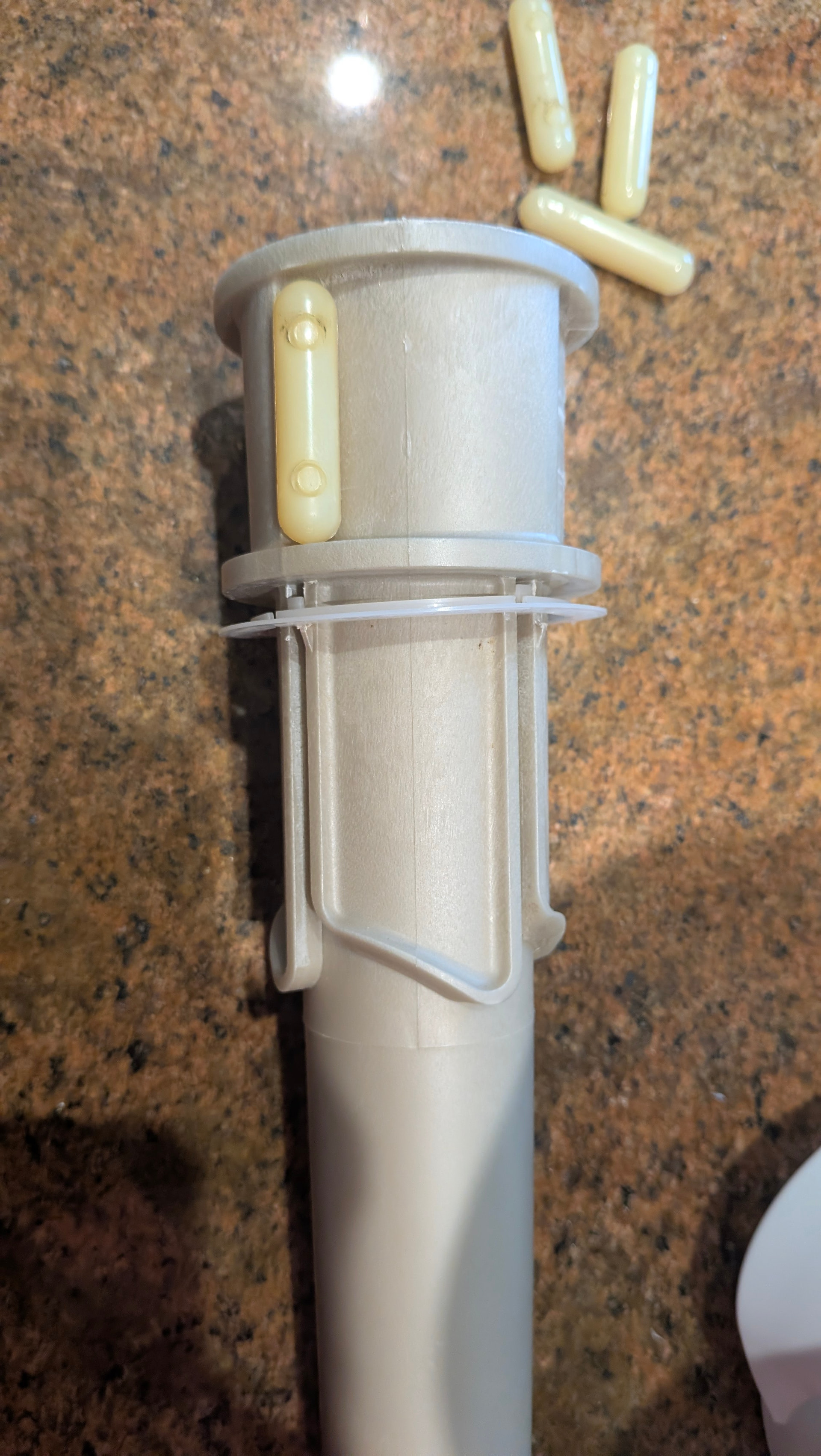

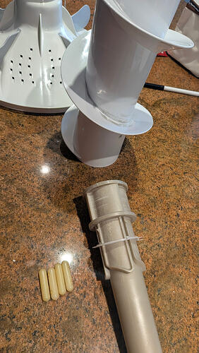

What happens & when:The dogs I have are “pill shaped” unlike most repair videos which show curved dogs. I have everything disassembled, but cannot find where the new dogs slot in?
Am I missing a part? It looks like they fit right here?
I see the repair kit shows as NLA.
Those are rollers rather than dogs.
