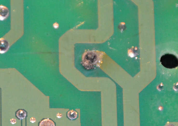

Had the same problem myself, and fixed it thanks to this thread. Thought I’d post some pictures if I can.
Here’s the relay that switches on and off the compressor:
Remove the board, flip it over and examine the back side. Here’s the bad solder joint
close up view
Touch it up with a bit of solder. You will need a fairly high wattage iron for this. Probably 40 or more watts. Put it back in and works perfectly! Thanks!
