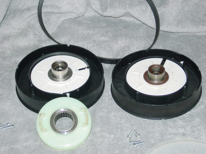

[COLOR=black][FONT=Times New Roman][SIZE=3][FONT=Calibri]I’ll post a pic of Clutch Pulleys from a Series 10 machine on the left and a Series 16 machine on the right. The Series 16 machine did not use the Upper Bearing One-Way Roller Clutch bearing ring and because of that has a slightly different Outer Tub design. [/FONT][/SIZE][/FONT][/COLOR]

[COLOR=#333333][SIZE=3][FONT=Calibri][COLOR=#333333]If your FAV6800A has the Clutch Pulley configuration with no Upper Bearing ring then we need to discuss what the next step is. Remove the front panel to inspect and comment back on what you find.[/COLOR][/FONT][/SIZE]

Left stide new _Right Side old Clutch Spring I did not use left side upper bearing assembly.JPG (76.7 KB)

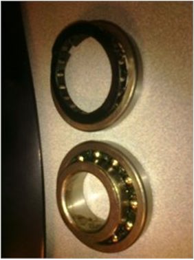

If we are talking about the Outer Tub bearings did the lower Bearing look like the pic’s below?

Series 12 and above intergrated 1 Way Roller Clutch Lower Outer Tub Bearing Assembly 1.jpg (15.6 KB)
Series 12 and above intergrated 1 Way Roller Clutch Lower Outer Tub Bearing Assembly 2.jpg (13.4 KB)

““What you are showing in the pictures is exactley what I need””
Just to clarify the bearing assembly I show in the pics is not the 6207-2RS. That bearing assembly comes from the FAV6800A and FAV9800A that have a Clutch Pulley that does not use the Upper One-Way bearing ring.

The clutch for my machine looks like the one on the right in the picture that you sent. When I orderded it, it came with a seperate bearing attached to a white nilon spinner with two tabs on top. A note in the box said to discard this for my machine, seems like a waste.I will order the spinner suport bearing and replace it as I have the machine this far down.
