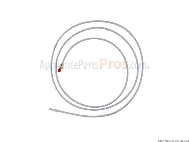

Whaterline leak
Brand: Whirlpool
Model Number: ED2JHAXTS01
Main Symptom: Waterline to Water filter housing came loose
What happens & when: water leaks under the fridge when water is turned on to the fridge
Pillutla,
With the water leaking as soon as the water supply is turned on, this will either be the inlet tube that is faulty or the water filter housing is bad. You will want to try to see if the tubing is actually leaking and if it is not then the filter housing would need to be replaced. Here are links to both.
