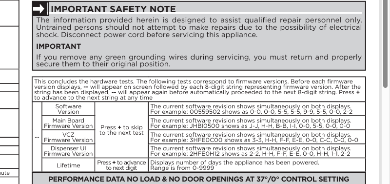

Hi glenh570, I’ve posted some diagnostic steps you can try performing. Follow those steps and let us know what you find. That should help us narrow down exactly what’s causing the issue.
I do not understand your photo and what does this have to do with the water line. As I stated before it will make ice. The water will not dispense. I have tried the obvious solutions..unplugged it for 5 days. Replaced both water filters. Checked for blockages
Also I do not see the diagnostic steps
Hi sorry that wasnt for you.
