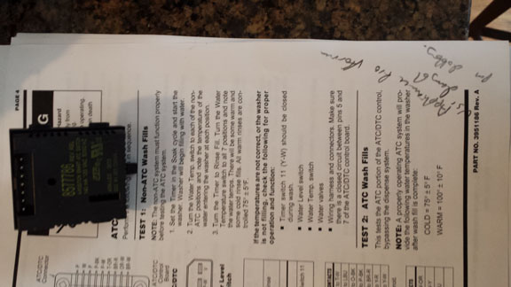

I had exactly these symptoms yesterday with my Kenmore washer, hot and cold pulsing about twice a second. I replaced the ATC / temperature switch, the issue is resolved.
Went through a fault find with Fluke meter, verified the thermistor was good (between 20 - 120k Ohms) and the ATC had the correct “demand” for fill from the timer (switch 11 & 12, 120V). Depending on where the temperature was set the hot and the cold solenoids were being sent a pulsed 24 VAC signal.
I believed the Whirlpool shares the same parts as the Kenmore. It is a combined ATC board and switch 8577786
