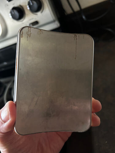

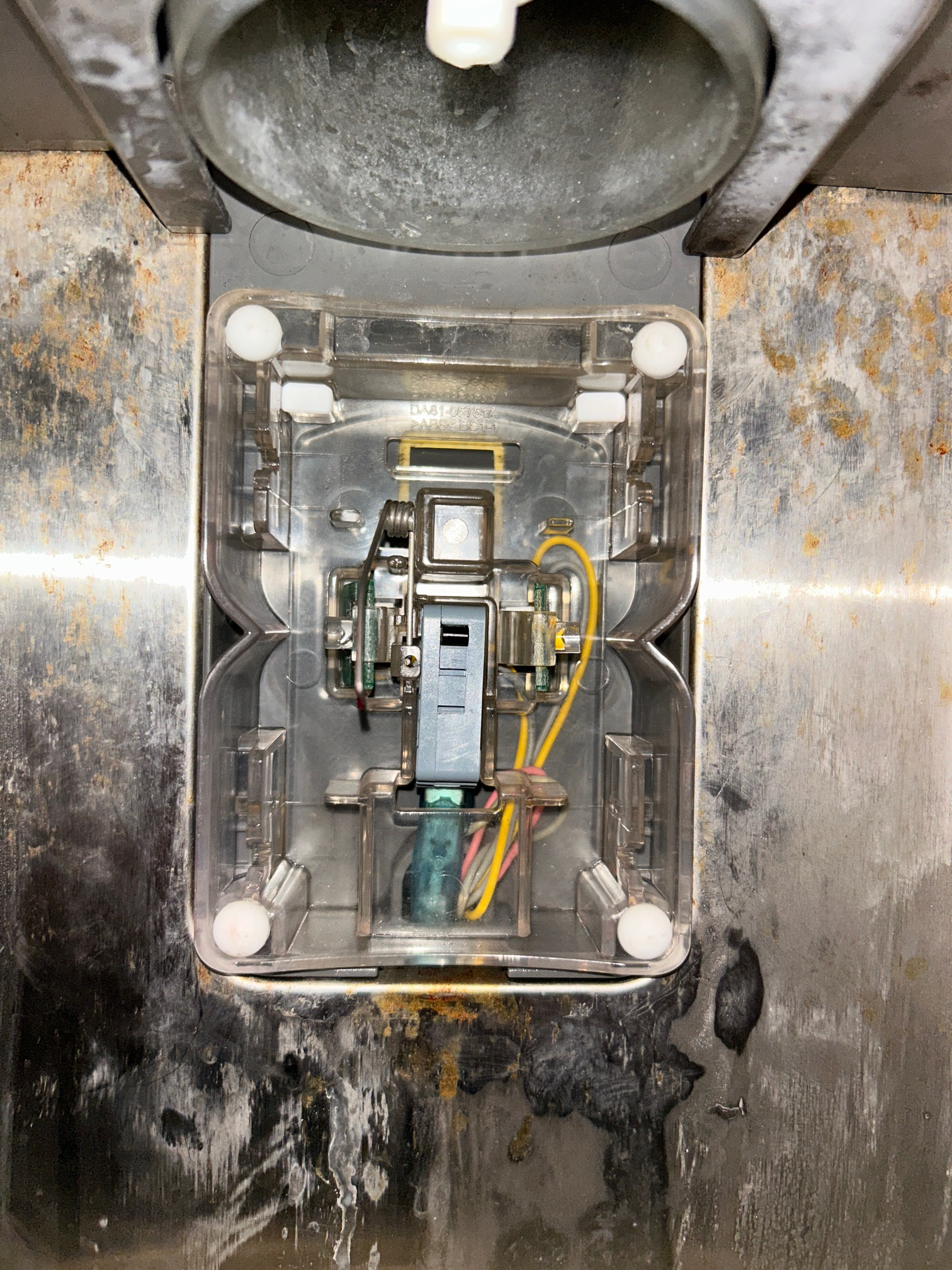

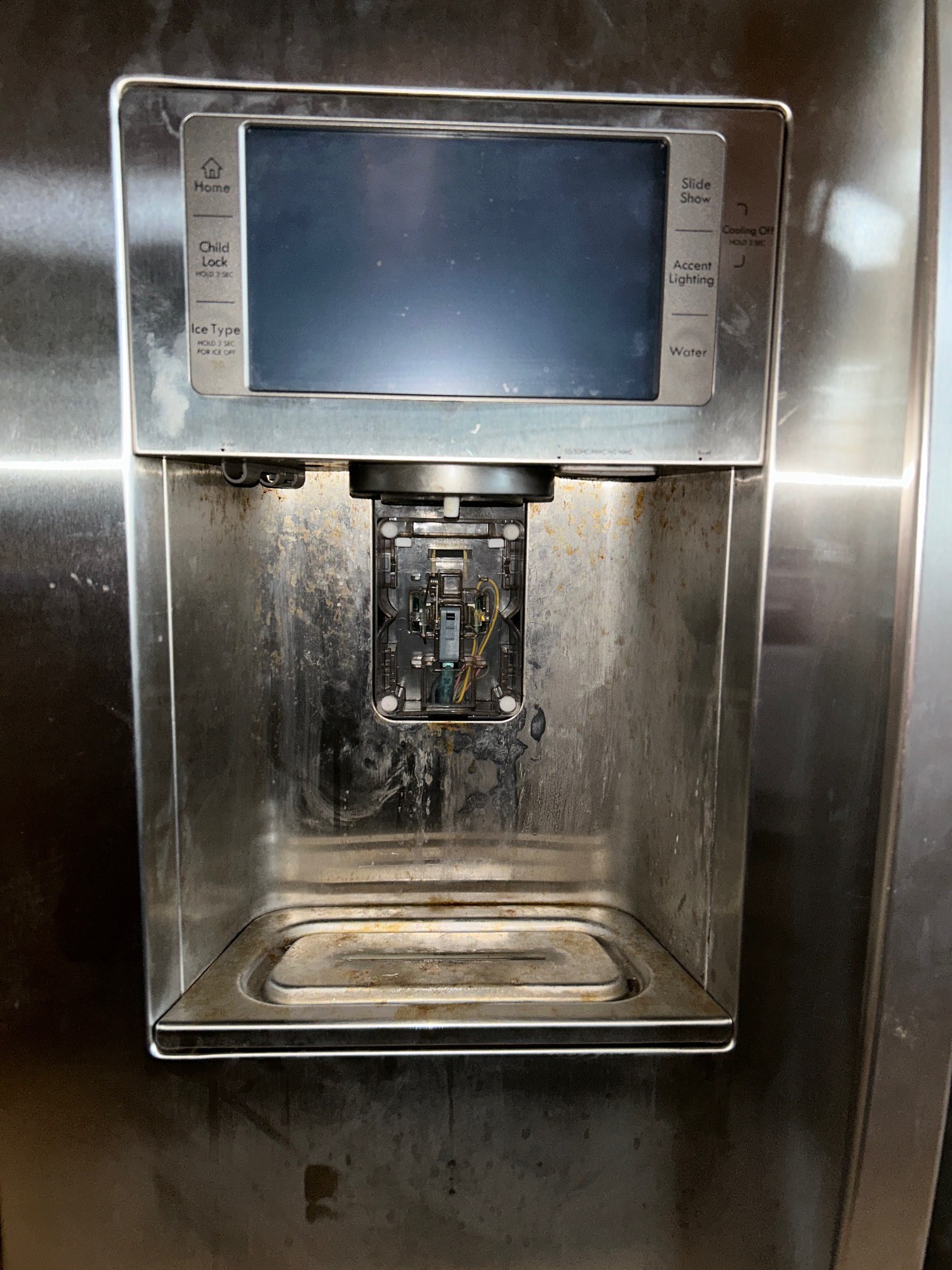

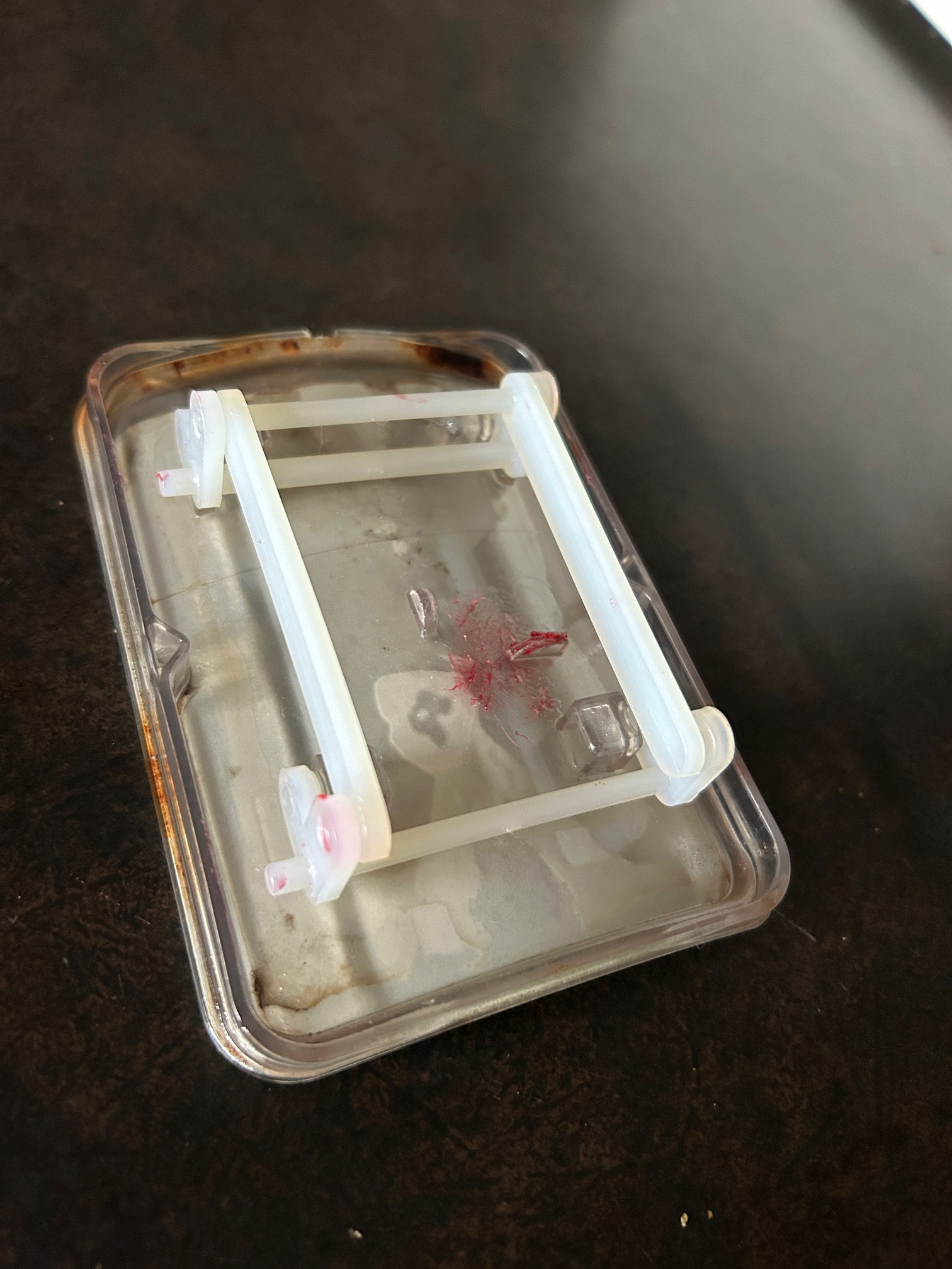

Need to replace micro switch behind paddle. Gently pulled paddle off to troubleshoot, now paddle will not clip back on. Nothing broken. I suspect I need to remove case from door, install paddle, then reinstall case but before I attempt that I thought I would see if anyone has experience with this? Thanks in advance!
Dis-assembled the module assembly and re-assemble form inside out.
