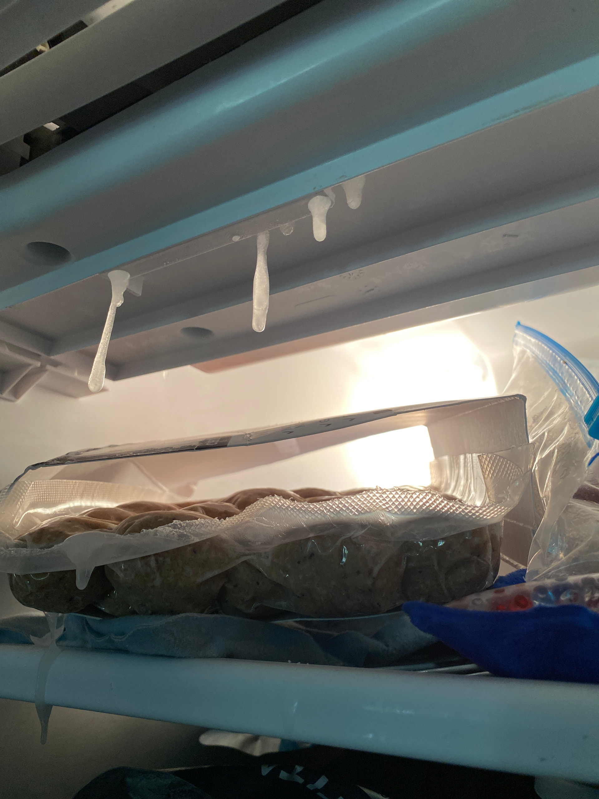

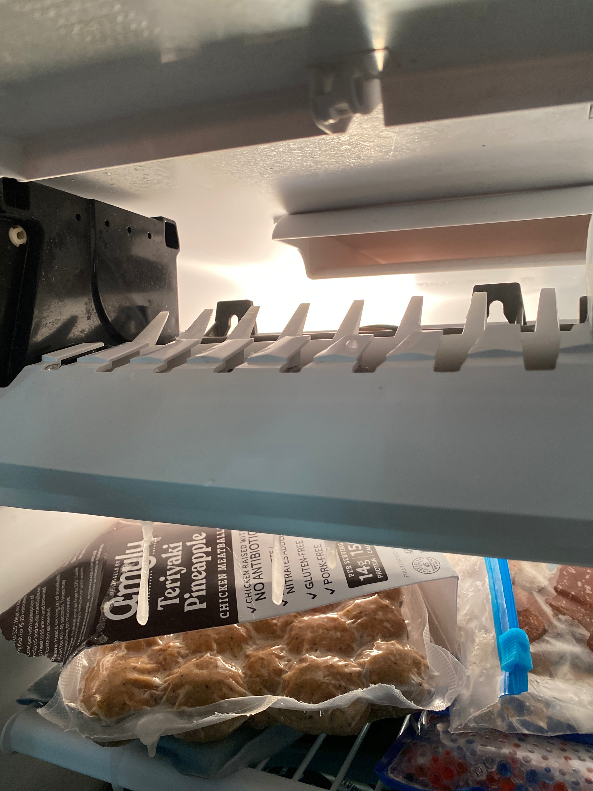

Thank you for the reply. There is no water at the bottom of the freezer or outside of it. It is only at the top of the freezer where the ice cube maker is. It’s almost like the ice cubes start to melt but then re-freeze leaving an icicle affect running down from the ice maker. The ice maker makes ice without a problem
Is it possible that the fill valve is allowing a slow drip that is causing the ice? can you send me a picture?

I turned off the ice maker and removed the ice. When I do that there is no more leaking from the ice maker. Only when I turn the ice maker back on is when I see the dripping
Thank you, that is a very helpful test. Since the leaking stops completely when the ice maker is turned off and the ice bin is emptied, we can narrow the problem down to the ice maker water fill system rather than the dispenser.
The most likely causes are:
A water inlet valve that is not closing completely. Even a very small seep past the valve can allow water to slowly drip into the ice maker fill tube between fill cycles. That excess water eventually freezes or overfills the mold, causing the dripping you are seeing. This is the most common cause.
A cracked or partially frozen fill tube. If the fill tube has a split or is restricted with ice, the incoming water can spray or continue to drip instead of flowing cleanly into the ice maker mold.
An ice maker that is overfilling. If the ice maker is commanding the valve to stay open too long, the mold can overflow. This is less common than a leaking inlet valve but is still worth checking.
The next thing I would do is remove the ice maker and inspect the fill tube where it enters the ice maker. Look for ice buildup, cracks, or evidence of water running down the outside of the tube. Then, after the ice maker completes a harvest cycle, watch the fill. The water should flow cleanly into the mold and stop immediately when the fill is complete. If you continue to see drips for several seconds after the fill ends, the water inlet valve is almost certainly leaking internally and should be replaced.
