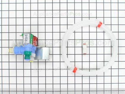

How do you test to see if it is functioning properly?:confused:
What is the exact problem?
What is the complete model number of the refrigerator?
Refrigertor #ED22QFXHW00 Whirpool Ref.
Water inlet valve #2304833
Same the question ,How I test water inlet valve work or not
. The water cannot pump into ice maker ? It’s problem water inlet valve ?
Swap the wires between the red and green solenoid. Push the water release lever on the water dispenser for a few seconds. Check if there is water in the ice maker.
If there is no water, check the water fill tube which comes into the ice maker.
If the fill tube is clear, replace the water inlet valve.

Yes I swap the wire but the connetcor from green not fix with conector from red solenoid then i conect by wire then the water leak on floor . do you think solenoid not working ?
[QUOTE=ngoc101;335258]…then i conect by wire then the water leak on floor …[/QUOTE]
Can you describe it more detailed?
That mean I swap the wires betwen red and green but the conector from green wire not fix with the pin of red solenoid ( the pin from red biger ,see the picture )But I still conect by wires, then the water leak on floor from the tube of red solenoid . see
Is this tube broken?
Did you check the water fill tube which goes into the ice maker? Sounds like it is blocked.
The tube is ok .the tube from red solenoid go into ice maker, I didn’t hear nothing .How you check solenoid( green and red one ) still working ? like test by the meter , think the red solenoid is bad ?
Can you give me the idea ? You think I need replace the water inlet valve and order the new one?
