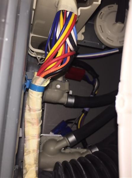

I have an LG front loading machine. I noticed water underneath and when I took off the back cover, I notice water dripping from the hot water inlet valve.
Has anyone heard of this before? I am wonder how difficult it is to remove the top to access the valve.
The round circle in the picture is actually a drip of water.
Any ideas or suggestions. Also a part number would be great!
Thanks!
Hello Jimh64,
The hot water valve AP4441935 can be easily accessed by unplugging the washer from its’ power supply and removing the main top. The main top is removed by locating the screws at the rear of the unit retaining the main top toward the front of the machine. Once removed, the main top will need to be slid rearward a few inches before it can be lifted up and off of the machine.
The water valves can split and emit a fine spray of water. Once the top is off you should check for a spray of water since the water could be sprayed from the cold valve AP5986564 and dripping from the hot valve. This would be done with the unit unplugged but the water supply faucets turned on.
