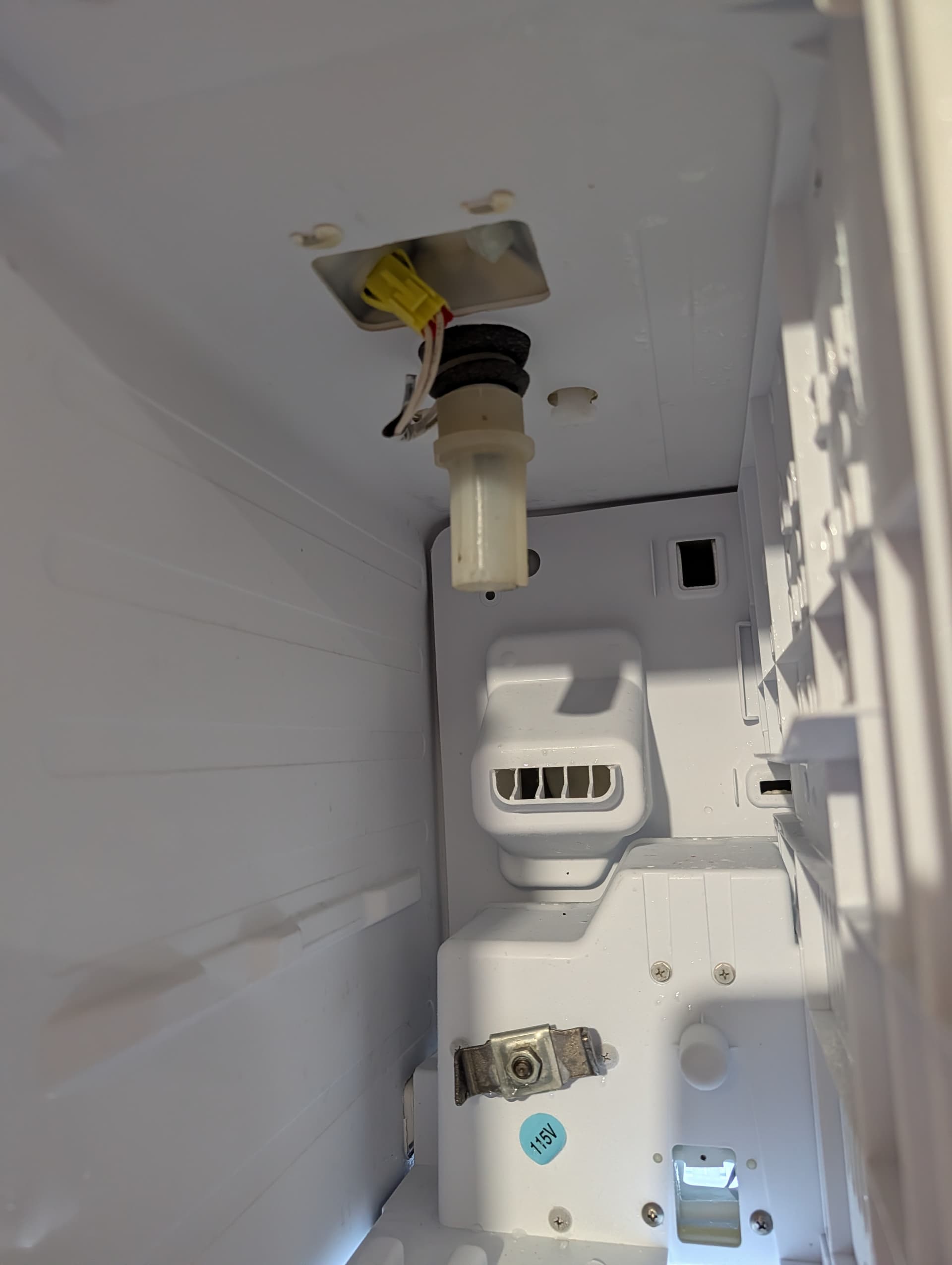

Water connection will not shut off
Brand:Samsung
Model Number:rs25j50
Main Symptom: Icemaker water won’t shut off
Turn the water off at the back of the refrigerator until you can determine the problem. Either the water valve is stuck open or the icemaker has failed in a fill position
I just purchased and set up a Samsung side by side and the water won’t shut off. The water is coming from a silicon covered tube located in the ceiling above the ice maker. I am guessing that there is some overflow switch that is not working. Any suggestions on how to fix it?
Done. Now what do I do to fix it?
