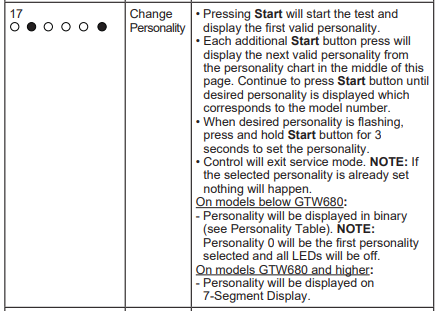

Will it let you into consumer mode? If it does, will it let you change/enter the personality code on test 17?
These are screenshots from the tech sheet for this model.

Not it will not let me into that mode! Not sure what is going on with it or how to troubleshoot it now.
Ok, try programming it using these instructions I’m attaching. If that doesn’t work you’ll need to contact our customer service team @ 1-877-477-7278 to arrange for a defective board replacement, in which case you can reference this thread.
