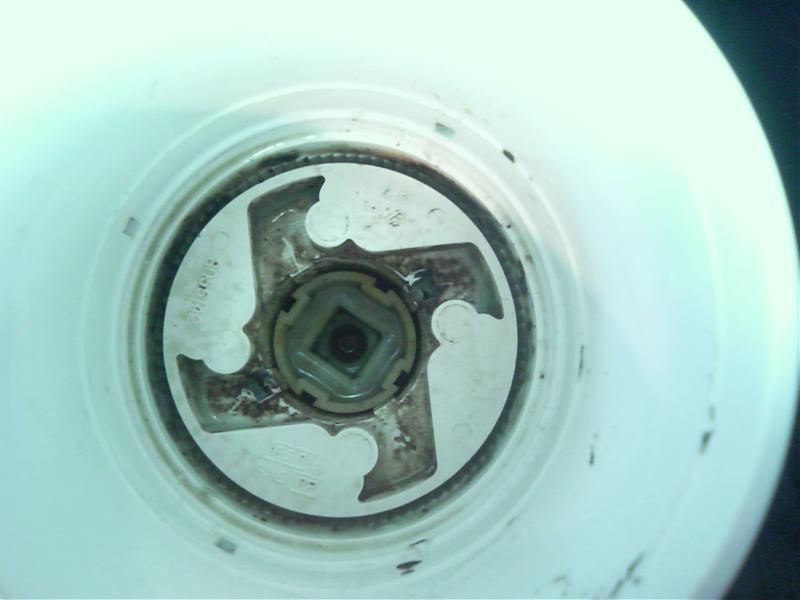

  1. the long skinny top part of the agitator does not really spin that forcefully so i went out and bought dog ears to replace and cannot access that area to replace the parts. It turns but when it’s filled with clothes it doesn’t look like it’s moving much but when you put your hand in the machine and feel low to the bottom that bottom agitator part is moving very fast and forcefully like it’s supposed to. a) I popped off the cap where the fabric softner goes and then grasped the white cap under that and took that out. Then I see what looks like a square type bolt with a round center. I don’t seem to have anything that can fit that…I need something square to loosen it? I bought the dog ears (APP didn’t have them yesterday) and I’m having problems getting to them in order to replace them. Help!!!

Here’s a picture of what I’m dealing with. I have a 7/16 but the ratchet doesn’t appear to be long enough to readh down there. And, I’m not quite sure how a 7/16 will help since it’s round and the inside of this bolt is square with a small round inside.

Here is a repair guide for the agitator dogs, but yours does look different then what I have seen before.
http://appliancejunk.com/forums/index.php?topic=105.0
I wonder if it was taken apart before and maybe not put back together the correct way?
If you remove the washer cabinet you and run the washer you should be able to locate the leak.
Ok that’s an OLD one! Use a 3/8 drive with an extention. Should work. nat
Do you think it’s possible the bolt broke? I got this washer used.
If this is the case is there another way to reach it?
Would I have to go from the inside?
You’ll have to get that bolt out. The only other way I know of is to drill it out and replace the bolt too. Without that part off you can’t get the rest of the agitator off either.
