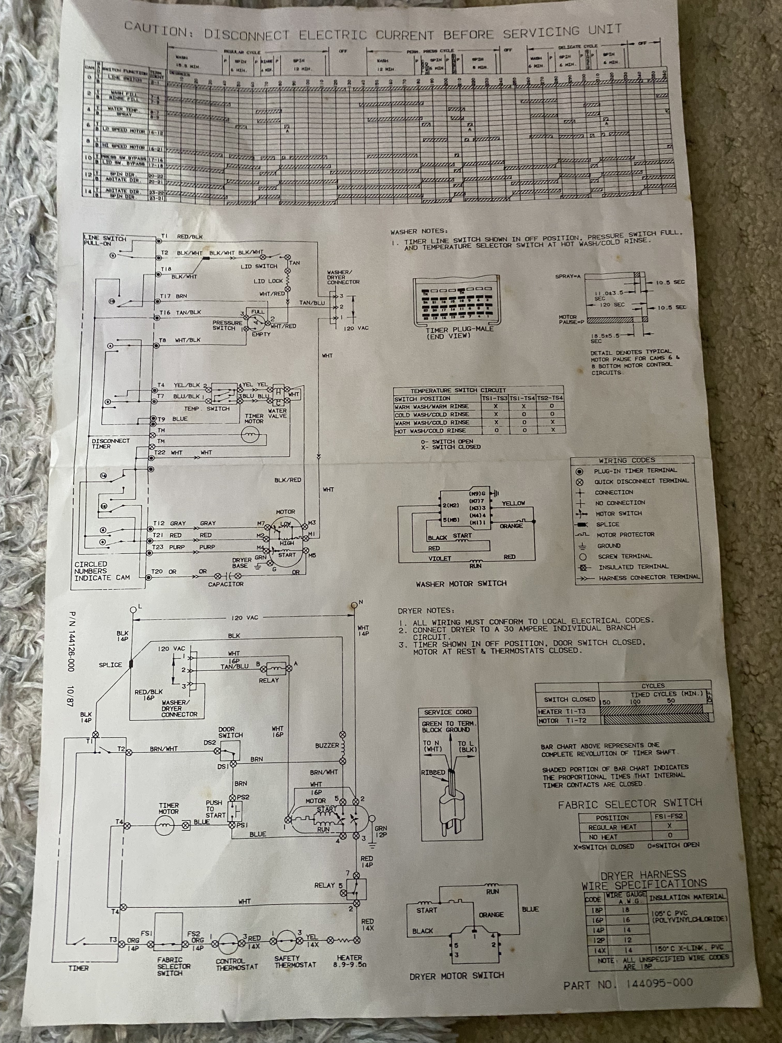

Frigidaire laundry center won’t drain please advise. See wire diagram.

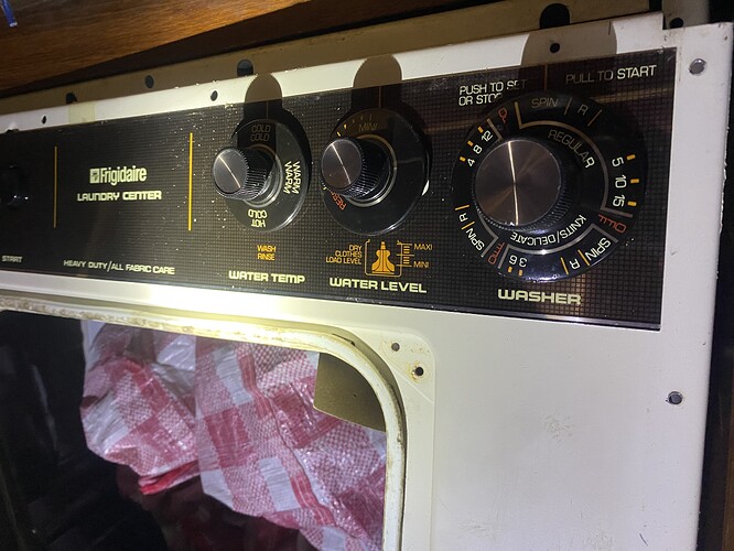

Timer lable and information
Timer label
Motor runs on wash and unit fills. Drain is not plugged.

If the model number of the appliance could be provided, it will let the most accurate information be provided. From what it looks like, the drain pump is probably the failure but the wiring diagram would indicate it is a mechanical pump not an electrical pump.
It’s mechanical pump. The unit goes quite when set to drain spin leading me to think the timer is shot ?

Without a model#, total guess but it appears that wash motor is a forward/reversing motor. It runs in one direction to wash/agitate and in the other or opposite direction to drain and spin.

Lid switch, timer, wire to the motor or motor itself would -seem- to be prime suspects.
