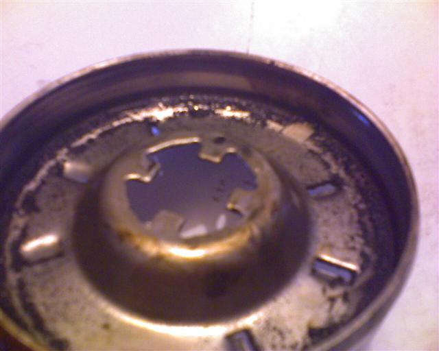

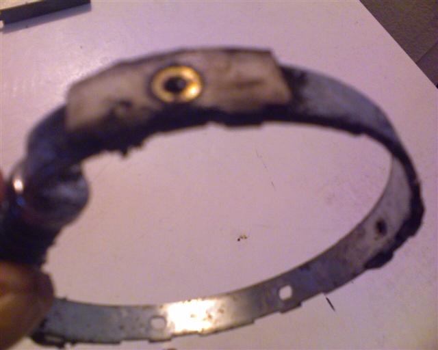

For prosperity, I’ll mention the motor coupling was fine. However, the clutch was pretty greasy and dirty. I’ve attached some pics for the above reason and for your review… I noticed a bit of debris on top of the transmission as well. I imagine this is attributed to the brakes and dust.

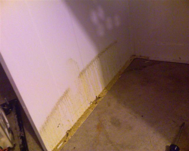

Also, there was some was gear oil on the inside bottom (both sides) of the cabinet. It looks worse in the picture than it actually was.

Inside clutch band lining (the little white tabs) seemed fairly worn- not to mention that inside the main clutch (hub?) was a little scored as well…kinda reminds when brake rotors on a car need to be turned.
There is a larger washer that looks similar to the inside center of the clutch (“bowl-like” convex). It sits above the clutch retaining ring (the U shaped ring that locks just above the clutch into the shaft grooves on the trans)…I’m not too sure how I took it off..

Well, as usual your information is very complete, and your pictures are very revealing.
Unfortunately what they are revealing is that your washer is in the process of becoming deceased. It is pushing up daisies, it has bought the farm, it is joining the other washers in that great recycling yard in the sky. It is becoming a dead washer.
The oil/grease splattered inside your cabinet is a deathmark. While you could repair it, it is not worth the money it would take. Normally I would say this calls for a trip to Mr. Washer Store, but in your case since you obviously have the ability to tear down a machine and make repairs, I would advise you to purchase a used Kenmore/Whirlpool Direct Drive machine. In our area you can get a nice machine for about $125 to $175 and I imagine it is the same in your area.
