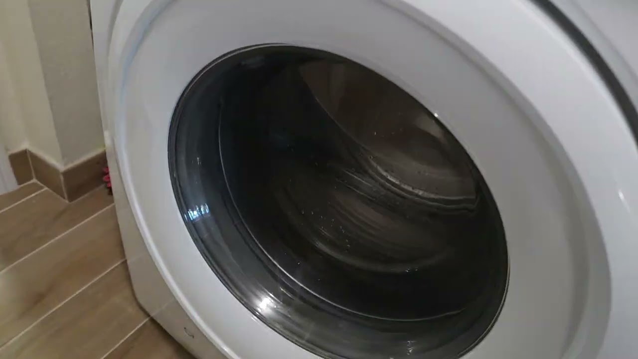

Washer spinning violently
Brand: Samsung
**Model Number:**WF42H5000AW/A2
Main Symptom: spinning erraticaly
What happens & when: replaced two front and one back shocks the drum spins at high speed but it looks like it is going to shoot out of the machine housing it was worse before changing the shocks and was making a loud noise
Its better now but it does not look normal when it spins at high speed when draining
Parts or tests already tried: two front shocks one rear shock
Photos / video link: video is available but I dont have a link however I can upload if instructed how on this page
Thanks for the video, that really helps. What I see and hear is a bad bearing and support shaft. At the backside of you basket, there is a support that attaches to the backside of the basket and the shaft runs through a bearing in the rear portion of the outer tub, that is what i see as being the issue. You would need to replace the back portion of the outer tub as well as the basket support. It is a big job.
