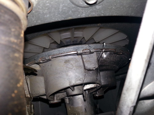

Okay, I found the leak. I filled the washer totally full of water and towels and checked on it after a few minutes. There was water spreading over the floor and I could hear a trickle. I took a picture.
I couldn’t get my camera at the right angle, but I was able to see the water flowing from the center shaft of the washer and over that metal piece.
After examining more I see that there was some water in the bottom, but it was in the very middle. The outer edges of the inside bottom didn’t really have water.
Will there be harm in continuing to use the washer with small loads until we can get a replacement?
Bummer, that is a major repair. Nothing beyond leakage will result if you continue to use it, other than maybe the bearing getting destroyed, but if you are replacing the machine it won’t matter anyway.

dear Rene HI I KNOW IT WAS 9 YEARS AGO. BUT DID YOU REPAIR It? WHAT DID IT COST YOU? I HOPE YOU’RE STILL ALIVE. please reply if you can.
If you have the same model and same problem, those parts are no longer available.
https://www.appliancepartspros.com/07-transmission-brake-parts-for-maytag-sav365zaww.html
Part 13 on this diagram. Also it’s a major job and a major pain in the neck to do. Sorry.
