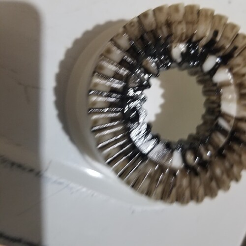

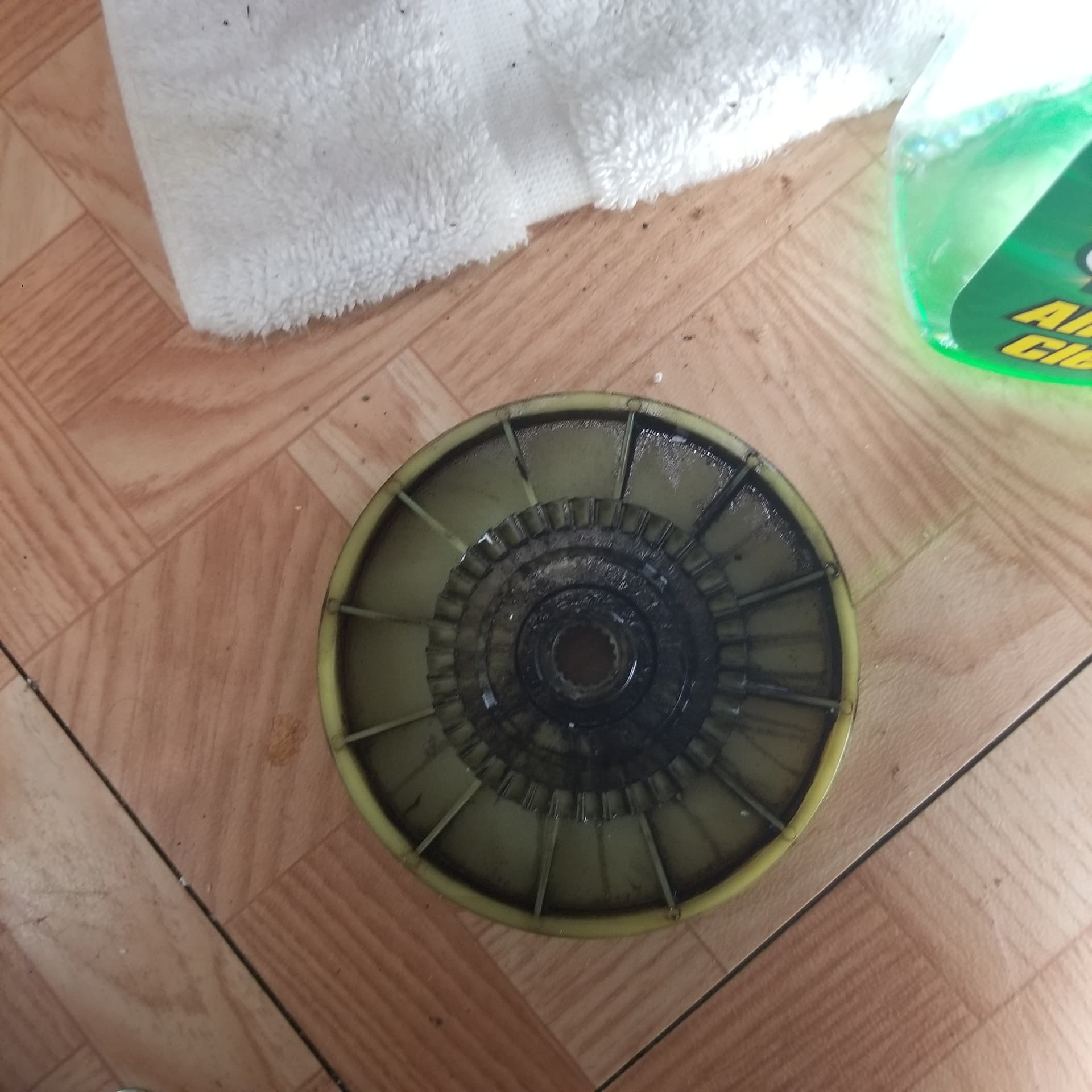

hello When i opened the slutch i found lots of black oil stuff on the parts pictures enclosed.. I checked the teeth even though they look fine to me but it could be worn out.. Let mek now if these pic mean something.
Faruk
Your gearcase is leaking and needs to be replaced.
https://www.appliancepartspros.com/whirlpool-gearcase-w11454741-ap6993917.html
